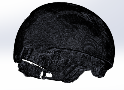

This 3d scan is actually a composite of two images. One from the top and one from the back. Fortunately the software has a MERGE function. I will say that it doesn't always work properly and I don't think it's user error. I should probably advise the manufacturer of this.
The following scanned item needs a back. I tried using the fill feature but instead it filled up everything including the main square hole. I haven't figured out how to fill everywhere but the hole in question. It almost sounds like I need a boolean instruction to accomplish this, but there is no functionality like that available. I don't know if Blender will allow me to do this.

so if i stand the part upright using a little bit of clay I can get something that is reasonable. Alternatively, because the geometry is simple, I may actually build the component myself in Freecad or Blender. Maybe Blender is better...
The figurehead is definitely outside what SolidWorks can do but the opening is an interesting case. I can certainly make the top part in short order but the bottom part would cause some difficulties. It would be interesting to compare the time, and cost, of making a part like this completely with CAD, versus scanning and then cleaning up.

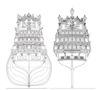

That small piece wouldn't present any real difficulty in F360, perhaps with a bit of sculpting to blend the curves. There are a few simples bit of decor like this on the SR. The figurehead and other figurines though, far too hard. But the scan looks really good and gives a great basis for improvement.

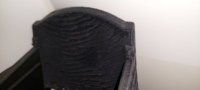

The only thing I am not sure about is that I don't have a resin printer. I hope that my filament printer is up for the challenge

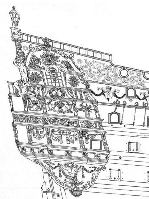

I am looking for someone/company that does figureines. I need to re-make the figurine that was/is on the stern of the Black Pearl. If anyone know of somebody, would you please let me know.
Thanks.
Phil N
Here you'll find all the Black Pearl figures
You might get borderline acceptable results with a 0.2mm nozzle, ABS filament and smoothing with acetone, but to be honest, if you have the setup that allows you go down that route you’re probably okay to run a resin printer. Just keep in mind (as you’re in Canada) that you’ll need the resin to be at at least 21 or 22 degrees and a few degrees higher is better.
A balcony could be okay if you can run the printer in a cabinet or suchlike. But even with wash & cure machines for the cleanup, resin is a bit messy, being a wet process. Having seen the quality of your work I don't think you would be at all happy with the results from a filament printer.
I agree. I have a filament printer (Qidi Xmax3) and a resin printer (Anycubic Photon M7). Not the latest versions, but both are useful. The filament printer produces strong prints but even on the finest settings, layer lines are visible and prints can take up to 10-13 hours for parts up to 200mm long. The resin printer produces very fine detail and layers are almost invisible, and it is fast. Despite care, it is messy, and even using water based resins it does have a slight odour, and my impression is that the prints are not as strong as the filament versions. The water based resins are MUCH easier to manage at cleanup time. I use them both at home, and they are tolerated by SWMBO. Currently coming to grips with Blender...another big learning curve. Apologies if this is a bit off topic.
