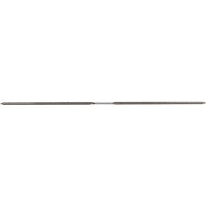

This is a set of very narrow files that is designed to make string slots in a guitar's top nut.
Thanks. I read too many negative customers reviews these. They say these files do not grind off much material as they are just scored stainless steel wires. Do you find them useful?
I have scarcely used them for modelling and like I remarked, mine are not the real thing. I do however suspect that most of those reviews are based on cheap specimens. A professional luthier would use this tool to shape the natural bone nut of an instrument worth thousands of dollars. By the way, a cheap set like the one above can be had for less than 5 euros.

This is a set of very narrow files that is designed to make string slots in a guitar's top nut. This specific set - my set - is not of very high quality, but those that are used by professional luthiers of course are.
