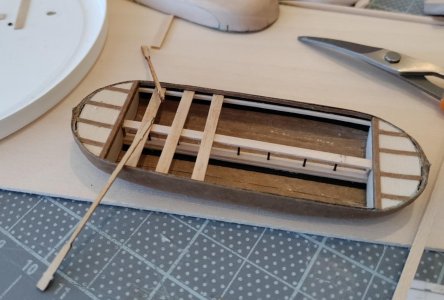

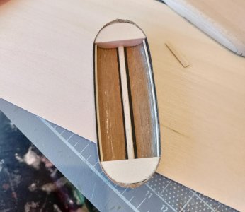

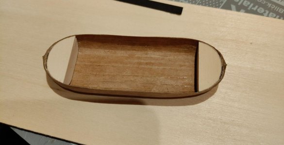

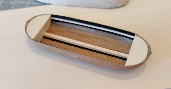

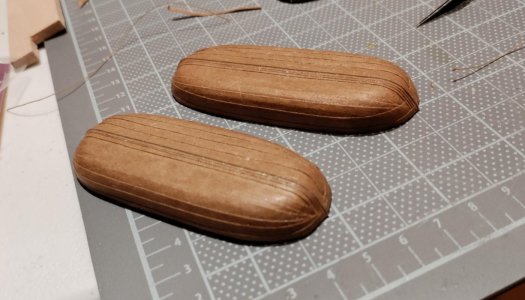

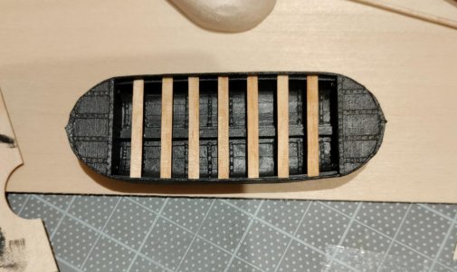

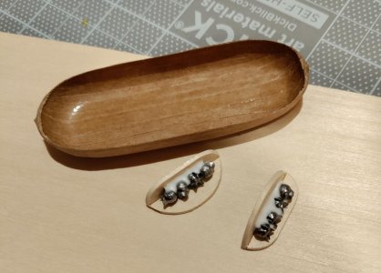

Thank you, Paul! Good shipmates are necessary for success! I'm positive that I would never have thought of paper, much less grocery-bag paper.Amazing construction. Congratulations to you for your execution and to those who tipped you off on this technique.
Good thing you're not in California, they outlawed our paper bags. To there saving the world. A Confederacy of duncesThank you, Paul! Good shipmates are necessary for success! I'm positive that I would never have thought of paper, much less grocery-bag paper.

Would have loved to see a YouTube video of you making both the boats and formsCalifornia? Never. Not for me. Besides, I got the best thing California ever produced - my wife!.
If you ever need brown paper grocery bas, Ted, just sem me a pm and I'll get them in the mail to you!

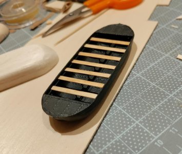

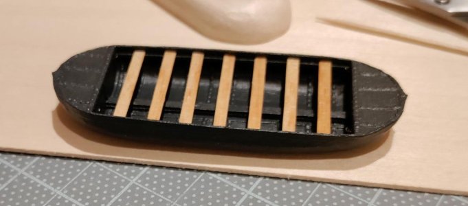

Martin! Many thanks, shipmate! I'm pretty happy with the result - so far . . .They look really good ! You've caught the steel riveted construction perfectly , i can almost hear them clank against the davits ! Bravo !!
