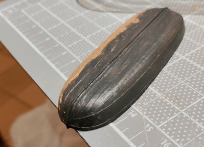

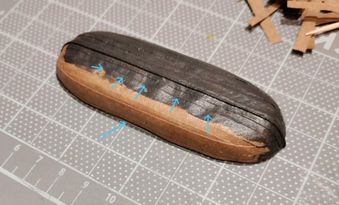

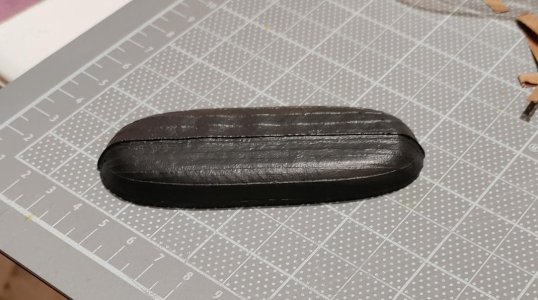

). These ripples were there, perhaps not quite so prononuced, when I took the bateaux off the buck. They really showed up after I gave the hull a coat of matte medium and painted. These ripples are not present on the shorter versions. I think this may have something to do with the length, but probably more to do with the number of strakes and the amount of overlap of the strakes. I also noted a tendency for the sides to want to curve inboard. I hope the decking and bulwarks at both ends will help with this issue. I foresee spending a few hours making a couple more bateaux-tambour, you know, just in case.

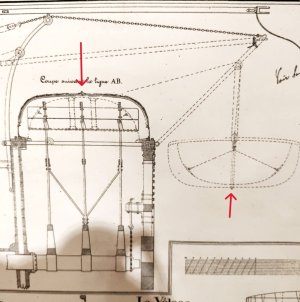

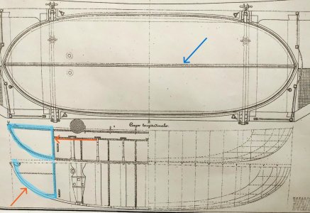

Jeff! I should have had a V8! Yes, your suggestion makes sense of the absent rudder. But it's a row boat 34'5" long weighing 5300+ lbs. I imagine that it would be hard to steer like a row boat. Also there's a step for a mast. Probably my lack of knowledge and lived experience that explains my hesitation about the absent rudder.If they use it like a row boat, they can steer it using asymetrical use of the side oars, like you would in a small rowboat.
Perhaps the rudder was shipped (removed) for storage, and mounted when the boat was deployed.Jeff! I should have had a V8! Yes, your suggestion makes sense of the absent rudder. But it's a row boat 34'5" long weighing 5300+ lbs. I imagine that it would be hard to steer like a row boat. Also there's a step for a mast. Probably my lack of knowledge and lived experience that explains my hesitation about the absent rudder.

Concur with Peter. Using spray paint or an air brush should also minimize that effect as the paint is applied with much less solvent soaking into the paper. Another option might be painting the paper before assembling the boat.I think the ripple effect on your boats comes from using water-based paint over paper. Perhaps it will even out given time, or even a little boost in drying with a very careful application of warm air from a hair dryer. At any rate I think the ripple will settle down given time as the paint cures. The acrylic has to cure as the water content is slowly released. I think the problem will exist whatever the paint vehicle. Probably to a lesser degree for a solvent-based paint.

Pete! I agree with you in principle.I think the ripple effect on your boats comes from using water-based paint over paper. Perhaps it will even out given time, or even a little boost in drying with a very careful application of warm air from a hair dryer. At any rate I think the ripple will settle down given time as the paint cures. The acrylic has to cure as the water content is slowly released. I think the problem will exist whatever the paint vehicle. Probably to a lesser degree for a solvent-based paint.
There was significant rippling before the paint job. I notice the issue when I took the prototype off the buck. I was also thinking that using enamel might be the way to go. We'll see . . .
Namabiiru! I think so too. I just find it strange that the gudgeons are absent from the detail of the original plans. I'll probably add a rudder to the bateaux-tambour that will be rigged out for lowering. I'll see what I can do to indicate gudgeons on the one that will be shown stowed.Concur with Peter. Using spray paint or an air brush should also minimize that effect as the paint is applied with much less solvent soaking into the paper. Another option might be painting the paper before assembling the boat.

Roger! Excellent! Thank you! I really like your thinking. Very bouyant but really heavy monsters stowed upsidedown. Hard to get into the water. So there needs to be a really good reason to go to the effort of turning them rightside up lowering them recovering them and turning them back upside down. A really good reason like recovering anchors, major vitualing operations or coaling. Plus there are five other ships's boats on davits easily lowered and recovered for the regular work of a warship.Chuck, I wonder if these are intended to be used as barges, ie. towed by other boats. The massive windlass shown on the drawing would indicate that they were used to lift anchors and the shape of the hull would provide plenty of flotation. As a European designed vessel, I would assume that she was intended to burn coal not wood. In the absence of developed coaling facilities these tambour bateaux could be used to haul coal to her while she was moored in the harbor.

Maybe sealing the paper boats with clear acrylic spray matte or pastel sealer will help prevent or minimize the absorption of water from acrylic. Also, the acrylics formulated for plastic modelers may not penetrate as deeply into the paper, they use a more alcohol like thinner.Namabiiru! I think so too. I just find it strange that the gudgeons are absent from the detail of the original plans. I'll probably add a rudder to the bateaux-tambour that will be rigged out for lowering. I'll see what I can do to indicate gudgeons on the one that will be shown stowed.
As to the rippling - I put acrylic matte medium down as a base and painted over that. Maybe the mistake was the acrylic matte medium? That porous grocery bag paper needs some kind of primer - right? Otherwise all it will do is soak up more and more liquid. I'll keep working at it - not including investing in an airbrush!
Good news is that I have plenty of stock to make the planks and I'm getting better and faster at producing the bateaux - So, if you're out there trying to turn your French steam frigate of 450 hp into something like the historical ship please feel free to place your order. The price will be determined by fluctuations in my emotional state.
Seriously - I think the number of strakes and the amount of overlap is the solution. The rippling is only present on the prototype - the one with the fewest strakes and the least amout of overlap. The grocery bag paper soaks up Titebond like a sponge. Based on the behavior of my second and third bateaux, I believe that absoption process and the additional overlap leaves much less "open" sponge to soak up the matte medium and the paint.
Add a little more patience, don't slather on the matte medium or the paint, release the blow-dryer on low heat at the right distance and the chances of successfully avoiding ripples increases dramatically! I believe.
