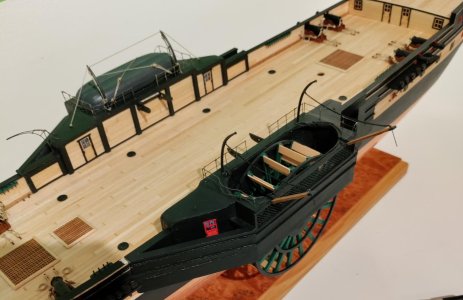

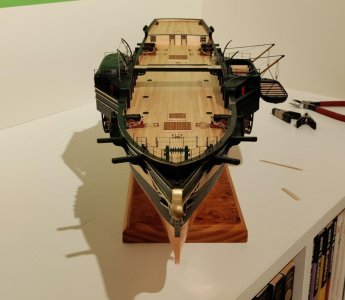

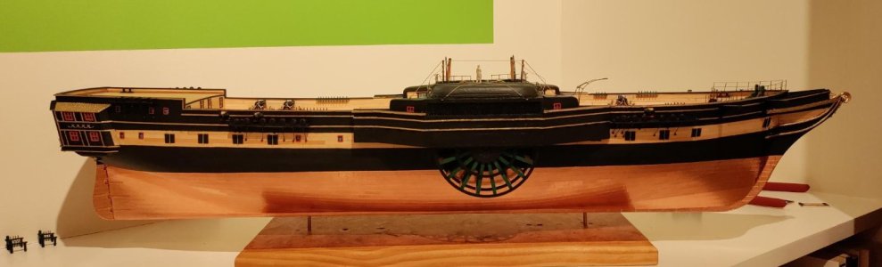

Do you remember last October when I wrote about rigging the port side tambour bateaux in a lowering position and all of the work you helped me do making the boat out of grocery bag paper? Even at the time I had grave doubts about my ability to make it work. As I struggled with the davit problem and the soldering, I thought seriously about scrapping the effort and moving on. If I had never talked about it, I might have done just that, such was the level of my frustration with the soldering. Just goes to show - sometimes if you talk about doing a challenging thing to people whose opinions matter to you, you just have to do it. Thanks, shipmates!

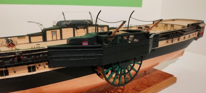

Below, pics of the port side bt rigged for lowering (and a couple of broadside shots of the starboard side which will be unseen one she's done and under glass).

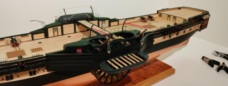

The lifting spars and the preventer chain. I have been concerned for a while how the chain might sag. See next pic.

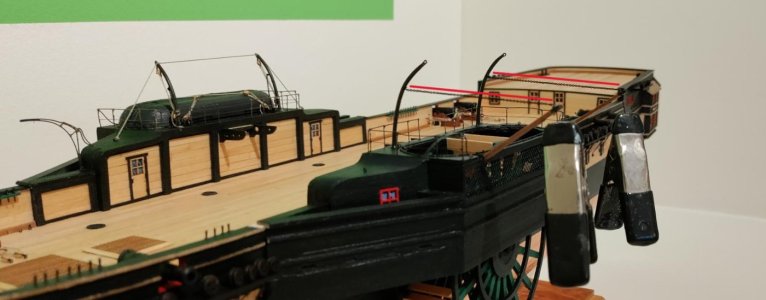

Here with some weights on the outboard ends:
The question is, will the bateaux be heavy enough to make the chain straight? I did put a bunch of tiny fishing line weights in the batueax for this very reason. And: Ta da! Victory!

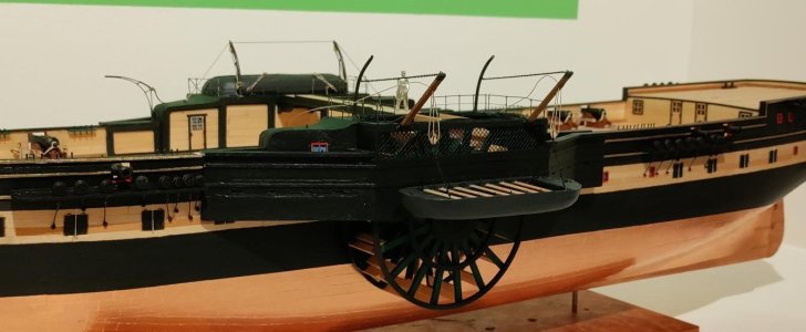

Still, the lowering lines don't give a sense of gravity in action at all:eek: No pics of it, but once I run the lines through the "sheeves" in the davits, there is decent tension to show gravity working on a heavy object.

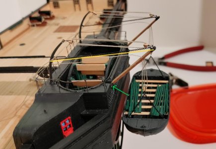

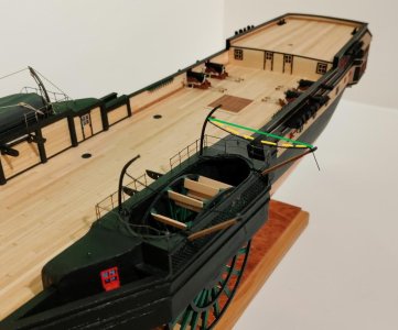

Just not quite enough tension, however, for my satisfaction. So, how do I make things rigid enough to get rid of the last bit of slack? Given my use of the British Royal Navy method, I can try gluing the lifting boards in this position (green arrow). And/or I can add the pushing spar from the French method (yellow line), but it will add clutter IMHO. I can also wait to see how much slack remains once all lines are belayed and IF there's just a bit, I can put a few more fishing line weights in the bateaux and paint the sagging lines with acrylic matte medium and wait until that cures before removing the weights.
In any event, I'll be unrigging the bateaux so I can permanently attach the port sponson to the hull with TitbondROTF And, no, I won't just have the oars jumbled acoss the thwarts like that when I'm done.

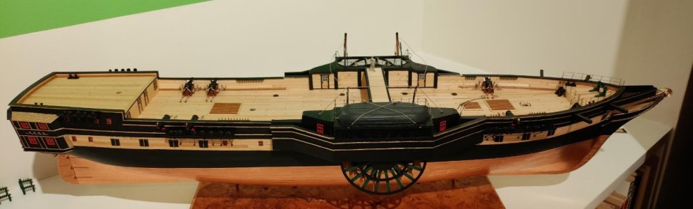

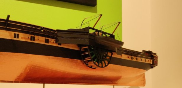

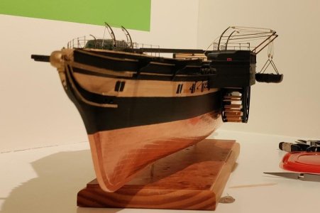

And finally the never-to-be-seeen-again-starboad-broadside.
View attachment 592284View attachment 592285
View attachment 592287View attachment 592288
A great idea and a great outcome, Chuck. The little boat is hanging nicely on the davits.
Peter!
Thank you for looking in on my progress! I was/am pleased. It's just the matter of the slack lines now. I am also thinking about running a couple of clear acrylic/plastic dowels from the side of the ship to the side of the bateaux to give the rigidity and it will make hanging the bateaux much easier - took me 45 minutes to get it right for these pictures. ROTF
Blessings. Peace. Gratitude.
Chuck
Peter!
Chuck
I think you’re on to something there, Chuck. The gap between the hull and BT is so small you could probably even get away with black dowels Either way, once she’s under glass someone would have to be looking from some pretty extreme angles to see the extra dowels
Namabiiru! I think it is worth the experiment! I could use black dowels that pierce the side of the bateaux hidden (mainly) by the thwarts. That way I can slide the bateaux onto the dowels and not have to worry about a glue bond holding against the sustained pull of the lowering lines + the lifting spar lines. Titbond (I had to do it ROTF - last time. Promise) works great, but I'd rather be safe than sorry. I'll get the necessary rigidity without adding clutter or needing to bury the lower ends of the lifting spars in glue.
Blessings.
Chuck
I'd try glue on the lines before anything else, easy enough to replace if it doesn't work out. I also thought to solidify the lifting spar hinge points. Seriously though it's just finessing , it actually looks really good. You may just find that the lines find their place after sitting for a few days with weight on the free end .

Thank you @Roger Pellett and @BradNSW and @Martin By Eye for weighing in on how to deal with the slack TB lines! Love the help problem-solving!

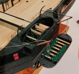

I buried weight under the coverings of both ends of the BT. Red arrows. There is really no pace to hide any additional weight. You can see the bottom of the TB easily and the thwarts don't throw that much shadow. Yellow arrow.
As to stiffeneing the lines - I tried this with Harriet Lane's port cathead tackle. I used acrylic matte medium. I was less than totaly happy with the result.
Should I be using something other than acrylic matte medium to make the lines stiff?
I definitely think i'd be tempted to put a maintenance crew working on the paddle wheel myself.
Martin! Thank you for sharing! I am extremely reluctant to go against my spirit guide's advice :p
As to the maintenance crew, having seen your models and their crews - I bet you would succumb to temptation!ROTF
Blessings.
Chuck
Hi Chuck.
In the post #29 in this specific thread about 'sealer for rigging' I mentioned --> Lineco Natrural pH PVA <-- I used is on my Bluenose and also on my Balder to kept lines in there 'natural' shape.
I use it diluted with water and after applying I set some tention on the lines to give them there wanted shape. Most of the time I give them 3 layers. Ones dried they kept there shape but they are still a bit flexible.

Thank you for the information! I now have the Lineco Natural pH PVA! It's been very busy at the end of the academic year so I haven't had much time in the shipyard. I look forward to trying it out soon.
