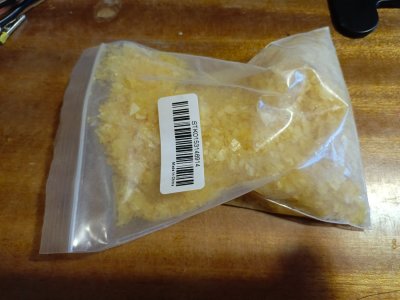

As a solid it comes in pellets which should have an extremely long shelf life. It is quite simple to make your own at various concentrations. You can mix it with acetone or alcohol. A one pound bag would probably be good for a lifetime of use.

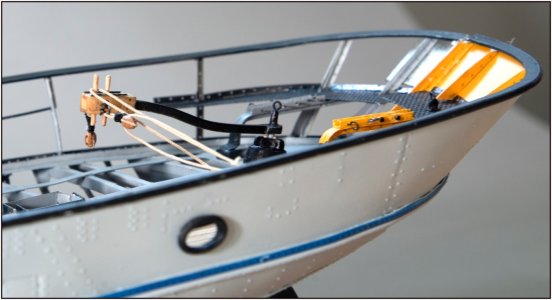

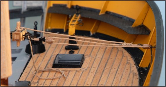

The line looks totally natural.To keep ropes in their 'natural' shape, or secure knots, I use Lineco Neutral pH Adhesive, diluted with water.
2 or 3 thin layers will dry transparent, without a glossy surface. Let it dry in the shape you wanted:
Before:
After:
Use the ‘search option’ of the forum with ‘Lineco’ and you will find lots of positive posts with the use of this PVA.

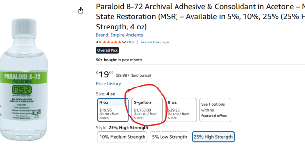

My comment was a bit if a joke - the 5 gallon offering at $1,750.00 is ridiculous for a modelerI suppose there's a savings in packaging, but I can't imagine a ship modeler having any reason to buy five gallons of mixed B-72!
