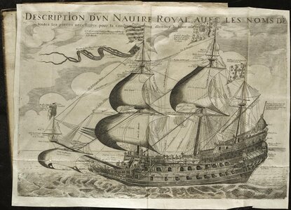

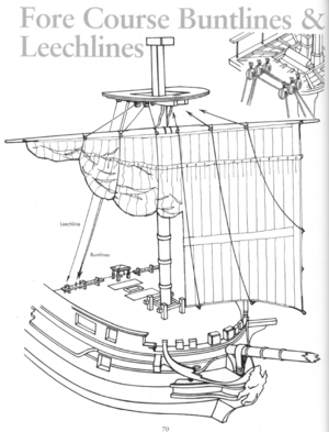

EXACTLY! What Petersson does with 18th century rigging with a simple picture takes one paragraph or even a page or two of text in R.C. Anderson's book to figure out where a line begins and ends in a 17th century ship. Even then, you have to pick out that one sentence and tiny incomplete drawing for the line's style by nationality. For a beginner, it takes reading Anderson's text two to three times to get it right. I tried to show the beginning and end points for some of the lines in my last build log for La Couronne, and most of those lines are guesswork from typical lines on known ships. There are no complete belaying plans for most ships of that time. You have to work from typical artist's images from the time such as this:
This is SO MUCH EASIER:
