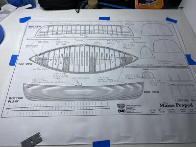

Unboxing it revealed an instruction manual, a rolled plan sheet, several laser cut basswood sheets, stripwood and a few metal castings. One cute casting was a metal lobster. One mistake I noticed in the instructions is where they have an stripwood identification guide which is a great idea. One of the pictures of a 1/8"X1/8" strip is labeled as 1/8"x1/16". The instruction otherwise look very complete and understandable

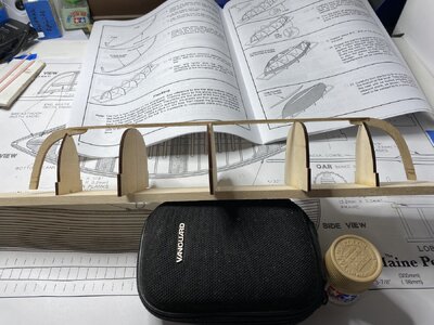

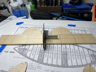

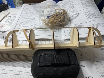

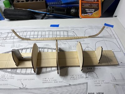

I then went about construction the building jig, using the laser cut forms along with a building board that was supplied. While CA was promoted as an adhesive, I decided to use PVA (Elmer's carpenter glue) as it gives me more time to align things. The parts were lightly sanded to remove most of the char produced when the parts were formed using the laser. I marked the center lines of the parts and, using the plans I marked when the forms were to be placed. I used a metal square to ensure the forms were square to the building board.

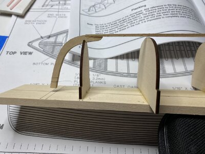

Using my trusty xacto knife and a small file I deepened the notches until the plank and stems fit properly and then, using PVA, I glued the stems to the building board. I made sure the stems were centered onto the building board. There was a small amount of "torque" with one stem wanting to sit to one side of the center. I used some push pins and rubber bands to hold things in place as the glue set.

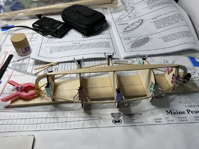

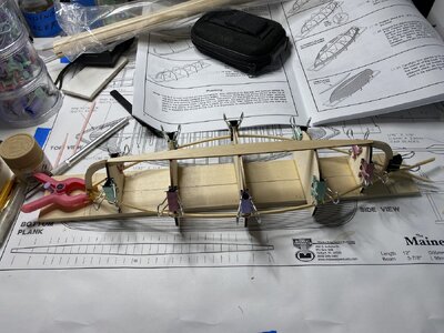

Now for my first row of planking. I beveled the end of two planks as suggested. I then laid the planks temporarily along the forms. Not surprisingly, there was some resistance of the planks to follow the curve. I decided to preform the planks using hot waster as I have done in the past with the Grand banks Dory and Norwegian Sailing Pram. I soaked the planks in hot water for about 5 minutes then set them in place using modified binder clips to keep them tight along the forms.
Once the planks had dried, I marked the other ends. I then cut them to length and beveled them. Both ends of the planks were glued using PVA glue to the stems.

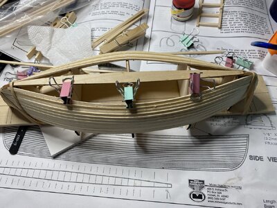

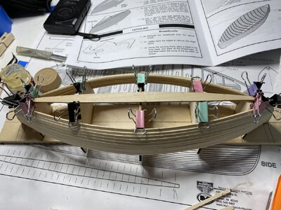

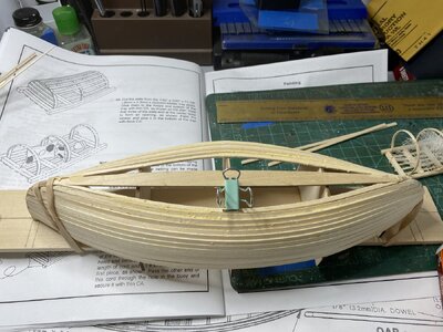

Slowly building up the planking by beveling the end on the stem. I then soaked the planks and fitted it to the frame securing them with the modified binder clips. I then trimmed and beveled the other end and let it dry in place. Once dried I glued it in place, using PVA to glue the planks against the stems and also adhering it to the plank below. I am careful not to allow glue on the frames.
img_8490-jpeg.434354

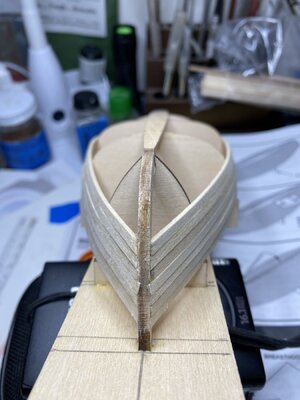

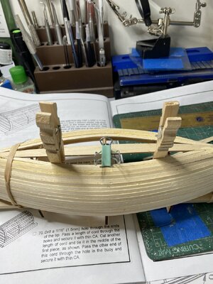

Building up the hull. This picture shows the front where the planks attach to the stems. You can see how beveling the planks allow for a smooth transition from the stem to the planks. This will of course be sanded even smoother. I am sure the planking will get more difficult the nearer I get to the keel.
