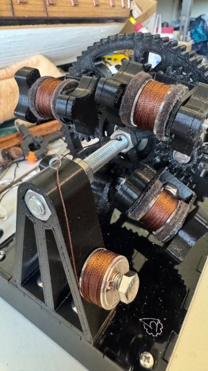

I don’t think i can do that with the PL4-4 rope walker from ship work shop.
Thanks for the explanation and the images. This explains a lot. I think I get it now.

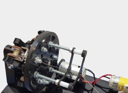

The PL4-4 I ordered feeds of bobbins that are used in some sewing machines and appears does not have the ability to do what you shown with the separate threads in each hock.
I would probably have to make each strand separately and wind those onto a bobbin and go from there. Which is no issue really.
But it appears for that reason these rope walkers like yours appear to be the one to use.
I don’t really have the room for a setup like that. So the pl4 for me was a better purchase as it don’t take up any room.
Which means with the PL4. I will only be able to do 2x1 3x1 4x1 or 4x1 with a core. This was something I was not aware off when I ordered the PL4.
Knowing this now. Would I have purchased the PL4? Probably not.
Although I do like how I will be able to make longer runs of rope and how little room it takes up.

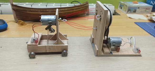

that pl4 looks awsome. i watched the videos (no sound was dissapointing) the planetary system simplifies the process but you are limited to whatever amount of thread on the bobbins... thats not a real game changer though. i doubt youll need 1000' of rope.
i saw another planetary system that allows you to use the original spools of thread, so no need for making bobbins.
then there is crisjaca's machine, very simple and straight forward, an easy diy project. ill be making a similar machine, as i have done in the past with my cub scouts after visiting mystic seaport (30 years ago).
i have an old norelco tripple head shaver im going to make into my motorized ropewalk. i have to make a seperator trolly and an end hook winder, thats this week's project. meantime, shopping for threads tomorrow. i really wont need the ropes till next year but this gives me a head start to get ready for re rigging my old ships.... ive got a clipper half rigged on the bench at the moment. too late to use custom ropes at this point.
thanks everyone. i bookmarked this conversation for future reference... lots of good info from the experts. luv this site!

PL4 + bobbin winder = endless rope
Video in attachment ;)

Not exactly. You can make multiple yarns on the PL4, but you have to load the bobbins with however many yarns you wish to use simultaneously so that the multiple yarns (threads) come off the bobbin together with equal tension on each. In theory, at least, and I've never done this, so I expect it's a lot easier said than done. Another possible method would be to simply twist parallel lengths of thread together and load that onto the bobbins. Finally, and this will definitely work, you can make up thinner three-strand rope and then wind that on the bobbins and lay that rope up as if each thin rope was a strand of the larger desired diameter rope. This is a common method for making large-diameter four-strand anchor cable.
The foregoing discussion is somewhat academic, though, since you can make just about any scale rope size you'd need up to 1.30mm diameter using three single strands of an easily sourced standard thread size (i.e., a "1x3" or "1x4" rope.) At 1:96 scale that's almost a 5" diameter rope, at 1:48 scale almost a 2.5" diameter rope, and at 1:24 scale almost a 1.25" diameter rope. That pretty much covers the necessary size range short of anchor cable which is made up of "three strands of three strand rope." There are, of course, also thicker thread available which will yield thicker three- or four-strand rope, as well.

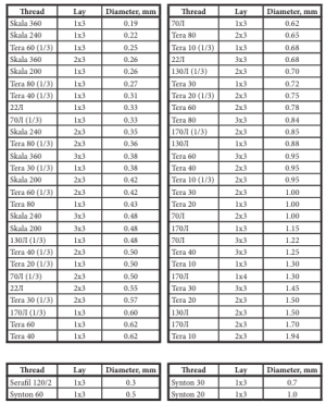

Below is a copy of the "rope recipe" Alexey Domanoff provides in the PL4 planetary rope machine instructions.
Note:
• 1/3 means that the thread was untwisted into plies, which then were used to wind the rope.
• 1х, 2х, 3х - number of plies in a strand.
• х3, х4 - number of strands in the rope.
• The real rope is measured by circumference. Here the diameters are given.

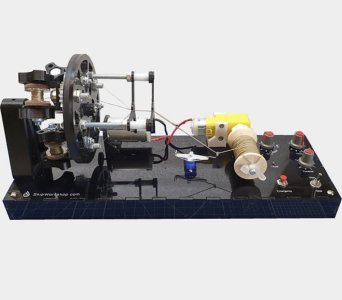

This is amazing. I just so happening to be watching reviews on this very product half hour ago.
The thing I’m trying to work out is can I use the supplied spool on the PL4 on this winder.

The spool pictured is the take-up spool that holds finished rope. I believe that's a part that goes with the machine and isn't a generic item. That said, if you wanted to store your line on a spool like that, it would be easy enough to turn a bunch of them on a lathe. Of course, I think most people store their made up rope in larger coils in plastic bags or the like because it has to come off the spool to be heat-treated anyway.
The planetary wheel itself holds standard sewing machine bobbins that can be bought for very little at any sewing store or on line. I got a bunch so I could store different sized thread on them and only make as much as I needed at a time. At least that was the plan. I still haven't had occasion to do that as yet!
The spool pictured is the take-up spool that holds finished rope. I believe that's a part that goes with the machine and isn't a generic item. That said, if you wanted to store your line on a spool like that, it would be easy enough to turn a bunch of them on a lathe. Of course, I think most people store their made up rope in larger coils in plastic bags or the like because it has to come off the spool to the heat-treated anyway.

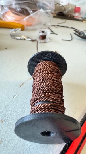

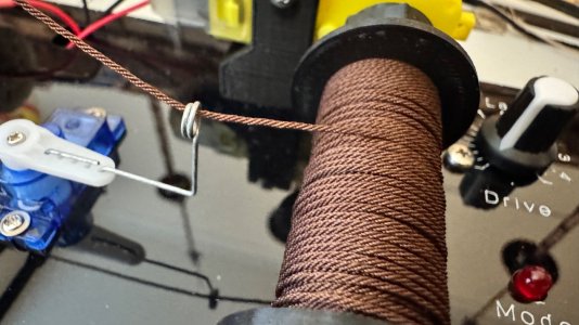

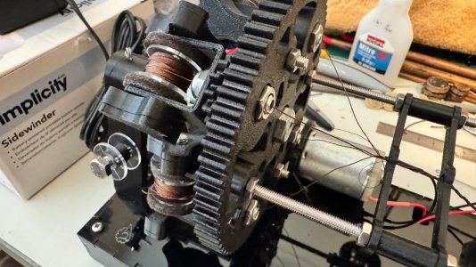

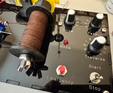

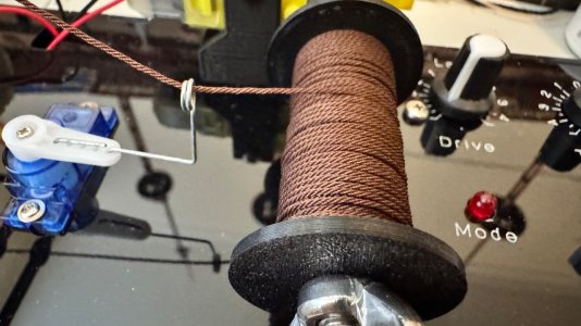

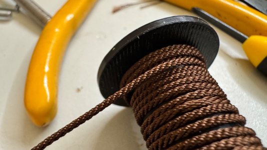

Not the smoothest start… but progress is progress.
My journey into making my own scale rope definitely didn’t start perfectly
Like most new tools and processes, there’s a learning curve — and I found it pretty quickly.
I purchased the PL4-4 rope maker from Ship Work Shop, because of its ability to produce fine, consistent rope with a correct lay for scale ship modelling. And to be fair to the machine — when everything was working as it should, it produced some very nice looking rope. The twist, consistency, and colour you can see in the photos are exactly what I’ve been chasing for my builds.
However… things came to a sudden stop.

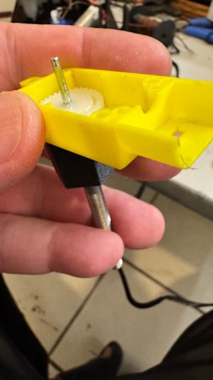

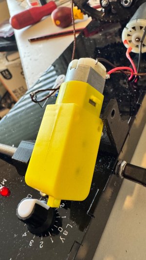

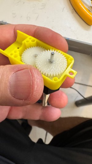

As I started running longer lengths, one of the bobbins began to over-run. The thread came off faster than it should have, jammed, and something had to give — unfortunately it was the gear inside the take-up spool that stripped.
After pulling it apart and having a proper look, I’m confident this one is on me, not the PL4-4.
Two key mistakes on my part:
1. I overfilled the bobbins, which added unnecessary mass and momentum
2. I had the bobbins clamped too tightly in the holder, so instead of slipping smoothly it built up torque
So just to be clear — don’t blame the machine. This was classic user error while learning a new setup.

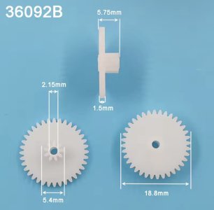

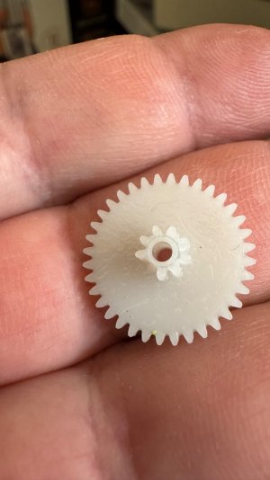

I located the damaged gear, took precise measurements, and managed to find an exact replacement on AliExpress. The parts are now ordered, which unfortunately means another delay while I wait for them to arrive.
Frustrating? Absolutely.
Unexpected? Not really.
The upside is that I now know:
• how sensitive the take-up system is to bobbin tension
• why correct bobbin fill levels matter
• and just how good the finished rope can look when everything is dialled in
Once the replacement gears arrive, I’ll be adjusting the bobbin tension and fill levels properly and adding smoother take-up control so this doesn’t happen again.
Setbacks aside, I’m still very excited about this path. Making my own rope with the PL4-4 is going to be a huge step forward in accuracy, consistency, and realism for my ship builds.
More updates soon — once AliExpress and the postman do their thing! ⚙️⚓
