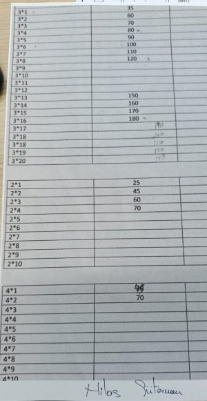

the thing is, how to scale the ropes needed on a model ship... im working in 1:96. i understand real rope is measured by circumference and we use diameter for our models. the complication comes in when choosing a thread. what size thread do i use for a certain scaled size finished rope?
i have no idea what that table is refering to. what is 2*9 or any of the left column means.

im still confused with weights for commonly available threads such as gutterman found in almost any department store. when trying to pick a thread color in a particular material, it only comes in one weight.. and there are no set standardized weights from brand to brand to reference. so how can i make several weight ropes for my ship if the thinnest i can make is already out of scale? id hate to buy so many spools n still cant find what i need. thats where your and other experianced diyers can help. i see you like one particular brand thread. ive never seen it on the shelves here so i can compare it to other brands for color and weight n material vs minimum finished diameter rope. i see you can increase diameters by using more threads or will that not be appropiate for righing n usage?
like i said, i dont know much about rope other than your linked post and a few other threads on the subject. its still very vague to me, especially with limited resources. in my 50+ years of scratch building ships, ive never used diy rope, only single thread off the spools. i also never used synthetic threads so im lost when picking synthetic materials.
btw what are the numbers in the center column of crisjsca's chart?
La cuestión es, ¿cómo escalar las cuerdas necesarias para un modelo de barco? Estoy trabajando en 1:96. Entiendo que la cuerda real se mide por circunferencia y usamos el diámetro para nuestros modelos. La complicación surge al elegir un hilo. ¿Qué tamaño de hilo uso para una cuerda terminada de cierto tamaño a escala?
No tengo idea a qué se refiere esa tabla. ¿Qué significa 2*9 o cualquiera de las columnas de la izquierda?
Buenos días, un cabo normalmente se compone de tres cordones, y cada cordón puede estar compuesto de varias filásticas, en la tabla el primer nº es los cordones que componen el cabo construido con Gütterman Mara 120, osea 3 cordones por una filasticas sale un cabo de 0´35 mm, 3 cordones de 2 filásticas sale un cabo de 0´60 mm, 3 cordones de 3 flásticas sale un cabo de 0'70 mm....así sucesivamente.
El siguiente recuadro serán cabos construidos con solo 2 cordones, 2 cordones x 1 filástica= 0´25mm, 2 cordones x 2 filásticas= 0´45, así sucesivamente...
El último recuadro seria para cabos construidos con 4 hilos, mismo sintema, 4 hilos x 1 filástica= 0´45 mm, y así todos...
El grosor de los cabos se mide, enrollando en una varilla, 10 o 20 vueltas del cabo a medir, bien pegadas las vueltas, se mide la anchura resultante y se divide por las vueltas. Espero que ahora se haya entendido. Un saludo.
Good morning, a rope is normally made up of three strands, and each strand can be made up of several plies. In the table, the first number is the number of strands that make up the rope made with Gütterman Mara 120, that is, 3 strands with one ply makes a rope of 0.35 mm, 3 strands with 2 plies make a rope of 0.60 mm, 3 strands with 3 plies make a rope of 0.70 mm... and so on.
The following section will show ropes constructed with only 2 strands, 2 strands x 1 yarn = 0.25mm, 2 strands x 2 yarns = 0.45mm, and so on...
The last box would be for ropes constructed with 4 strands, same system, 4 strands x 1 strand = 0.45 mm, and so on for all...
The thickness of the rope is measured by wrapping it 10 or 20 times around a rod, making sure the wraps are tight. The resulting width is then measured and divided by the number of wraps. I hope that's clear now. Best regards.
ooooohhh that explains it very nicely. i now see the numbers are 0.xx mm for each winding. thats worth a million bucks! thanks.

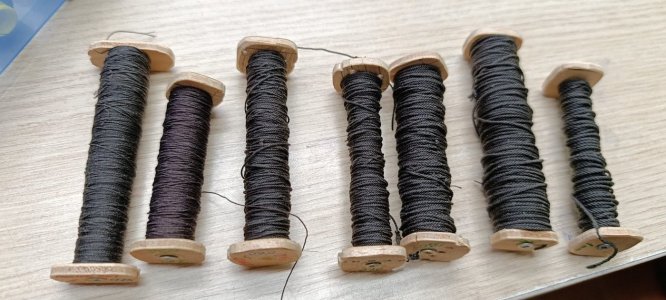

In regards to making your own ropes. I think I’m starting to work this out. As mentioned before I ordered the ship works shop PL4-4 rope making machine.
I’m waiting for it to arrive.
A lot of the mentioned ropes are not easy to find here in Australia.
I managed to find Guterman Mara 120 as well as Tera 20 thread online. There also on the way to me now.
My first rope I need to makes is for the main rigging of a 1:50 scale san Felipe I’m building. I’m looking at 1.5 to 1.7mm rope.
These threads I just mentioned. Can I make rope that thick?

nope, the first number is for the strands and the second number is for the count of yarns in one strand.
3 strand rope is the most common rope you make. 4 strands is difficult. because it could collapse without core.
2 strands? I make that only when I need very thin rope. It doesn't look good on thicker rope, like 0,4 mm diameter.
so 3x1, 3x2, 3x3, 3x4, 3x5.........3x20 are all 3 strands and the second number is how many yarns there are in one strand.
The rope making machine I purchased will twist upto 4 ropes together max at a time.
You discovered the limitation of that machine. I seen people solving that to twist more yarns on the spool before you start turning. But that is a lot of work. Or you need to use thicker yarns. I don't know how this wil look in the end result. When I look to people that are an example in rope making here on the forum, like Mati.n, Kudin or archjofo, they use a ropewalk like the real thing.
I like the PL4, sometimes I wished I had one. Especially when I need a lot of 3x1 rope. You always need that a lot.
As it seems you've discovered, there are a number of sizing conventions in the thread industry (two main ones) and the differences between them can get confusing. They are important if good scale rope is to be made, so you should pay close attention to the thread sizes. You can make thicker scale rope by either multiplying the number of threads you lay up as yarns in a
