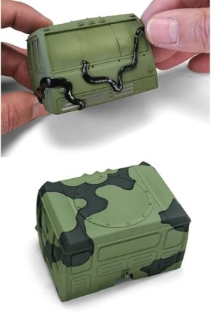

If you need to use or make camouflages with random curves, you can also use a type of very manageable plastic putty that can also be used to cover empty spaces between pieces and gaps and is very easy to remove.
I leave images of the masking tape and plastic putty and two links of the use of plastic putty.
