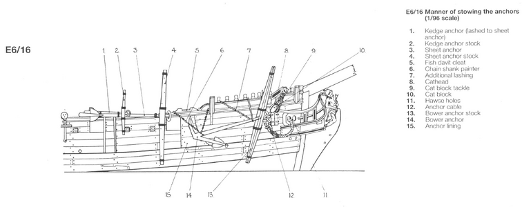

On the subject of Anchors (which is what the Viol and Messenger cables are there for, right?), would the extra Bower (or Sheet) anchor and/or the Kedge anchor be already fitted with anchor cables, or would they be simply stored as per Goodwin's drawings, with no anchor cables attached?
The extra Bower or Sheet anchor is a spare, as I understand it, so probably wouldn't have a cable attached, but the Kedge anchor was used for maneuvering, so possibly it would be rigged? Although it's pretty far away from the hawse holes (and cathead), so I don't know.

As I know, the sheet was not fitted with a cable,
and also the kedge was not fitted with a cable - btw: the kedge was usually manouvered via a ships boat and not from the bow
but also here I have to read some more .......
