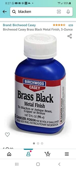

Hello, Kevin. Such a question popped up from time to time. I am sure we have answers scattered across build logs. I simple search (in the right upper corner) of the word 'blackening' reveals 7 pages of build logs. Not necessary all of them discuss how to blacken parts, but it is a great starting point
In short, I like to use the Birchwood Casey line products. They have products for brass and steel. The most popular among ship modelers in USA is Brass Black. Check this out.

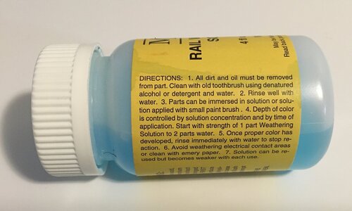

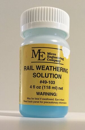

I have been using a Micro Engineering product called Rail Weathering Solution for blackening brass parts. It is available in many hobby stores/shops, and on-line but I am not sure outside N. America.
I have been using it for years and obtain great results weathering brass. I have not used it on ship brass cannons yet but will be doing so in the near future. What I like is you can adjust the solution to your needs. You can watch the blacking effect as the solution works on the brass. Remove the item, wash it in water (I use distilled) to stop the chemical reaction and then see if it needs a repeat soaking. I use a rag to buff the black residue off the brass item. It is important to start off with a scrupulously clean brass part otherwise the weathering solution will not react properly, especially if you leave oily fingerprints. You can reuse the diluted solution so I have a separate bottle for that. I always wear powder free vinyl surgical type gloves when working with this stuff.
