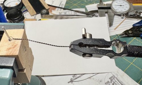

I want a metal look for securing blocks and deadeyes to the hull or other rigging parts. I have purchased some manufactured straps and rings but found them fiddly and often not the correct size, fit or look I wanted. I tried bending them myself using wire but still found it difficult to get tight fits and sharp corners around small blocks and dead eyes. I wanted something more malleable to hand form with no tools.
I tried solder and found it works perfectly. It can easily be bent tightly around any shape and be pulled and formed into any end shape or configuration needed.
It is strong enough for holding rigging tight and it can be secured with a drop of C/A.
Especially easy for small parts I have used this on 4mm blocks and 3mm deadeyes
using .015" solder. No heat just C/A.
