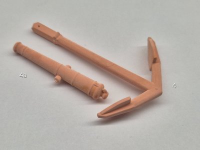

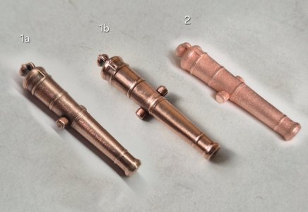

Test #2
In this post, I'll discuss common mistakes and the benefits they offer for further analysis before creating the desired result.
20. Holders. The ideal method turned out to be drilling holes and fixing (without glue) wire of the same diameter, and copper wire, into them! After copper plating, these holders can be cut off with wire cutters, and the end will be as copper as the rest of the surface, and after sanding, you won't find the missing piece. This is correct, but the quantity is more than sufficient – two, as it turns out, are more than enough for this size. They can be placed at the points of contact with the gun carriage. These same holders can also be left in place and will hold the gun on the carriage if you pre-drill holes in it.
21. Growth rate. The more metal growth points, the faster the entire part will be coated with copper and begin to build up a layer. This is theoretically possible, but! The more holders, the more metal in the solution, and this metal (the holders) increases the overall surface area. But the worst thing is that this metal (the holders) is coated with copper faster and absorbs current better than graphite. So, this statement isn't entirely true. In this case, it would have been possible to make 4-5 of them in different places and not press them against the figure.

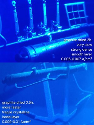

22. Mistakes. For the experiment this time, I did everything wrong! Firstly, the biggest mistake was not waiting for the graphite spray to dry completely. Last time, it took almost 3 hours, and this time no more than half an hour. I forgot about it and then applied this experience in the future. Also, I installed one large figure, a couple of medium ones, and many small ones at the same time (upside down in the photo). I also placed the small ones practically on the surface (high up, where there is little copper in the solution) and on the side (not in the plane of the entire composition, this is wrong). And what's the problem? The huge number of holders on the large figure consumed a lot of current, leaving none for the small details. Plus, a lot of holders ended up in the solution, which increased the already large area. Plus, the large figure has a very complex shape, which is very difficult to calculate by area. And as a result, I initially gave insufficient current - 0.1 A, which is very little for this composition (especially for graphite that has not dried completely). Unfortunately, I wasn't able to check earlier, but after 4.5 hours, there was practically no result. After that, I realized I could now experiment with doing everything the wrong way, to clearly demonstrate all the errors. I set the voltage overnight to 0.2A, which is also too low. And the result was predictable. The graphite failed to coat properly, and during this time, the wire and the already coated areas were drawing a significant amount of current and copper. Ultimately, I reversed the process and gradually increased the voltage to 0.6A, which worsened the situation, which is exactly what I needed to clearly demonstrate all the errors, both the low current at the beginning and the high current at the end.

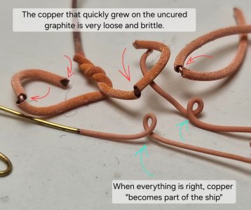

23. Corals or Sugar. Let's recap why this happened. What was wrong: 1) the graphite should have been completely dry from the start! 2) too many holders, which absorbed all the current, 3) insufficient current at the beginning, 4) too much current at the end. The result is a huge layer, loss of texture and geometry (if there are uncovered areas), a brittle coating, and I won't even mention the surface roughness. BUT, I did some experiments with guns and will talk about them later, so all this was worth it. I'll talk about this later when I talk about blackening.
I wanted to clarify again that copper deposited on graphite that hasn't dried (less than 2-4 hours) is very, very brittle. It breaks easily when bent and is definitely not suitable for rims (although roughness is also unacceptable for them). This is all because the copper didn't adhere to all of the graphite, but to the particles on the surface. Where the other particles (which should leave the surface after a couple of hours) are, it doesn't adhere, and this surface repeats itself higher and higher with each layer, forming crystals and producing a minimal copper density.
24. Consumption. Not counting my rigorous, multi-hour experiment, the solution loss due to evaporation and filtration (sedimentation) is about 3-5 mm across the height of this container. And after two applications, the copper plate has shrunk by half. But that's a measurement from the bottom. It's thicker in the middle and closer to the surface.
25. Filtration. Let the solution settle for a few hours and carefully pour off the clear portion. Pour the remaining portion into a small container and repeat (allowing time for settling) before pouring off the clear solution, leaving the sediment behind. The entire solution should be filtered at least twice simultaneously. I line the neck of the bottle with several layers of thick cotton cloth and filter it that way; a cotton pad will work as well. This is more effective for catching debris, as the sediment passes through almost everything, so it's best to remove it once it settles.

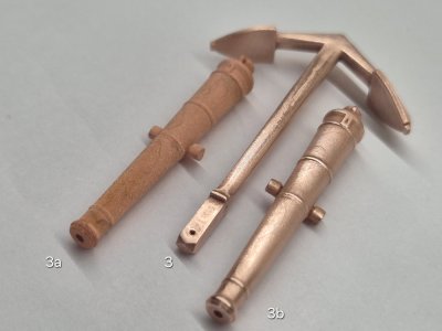

The results of this and subsequent tests will be at the end of the blackening section, allowing for a clear comparison of all the options.

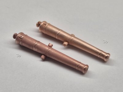

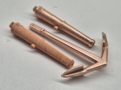

Test #3
Since it became known that poorly dried graphite causes "sugar" or "coral" granules to form on the surface, I wanted to take advantage of this to roughen the guns. After the first experiment, the guns were too smooth and shiny (but perhaps I simply overdid it with the 0000+ steel wool polishing, while 000 would have been sufficient). I'll cover this in detail in the blackening section.
So, a new approach:

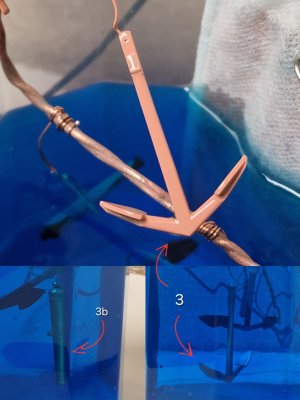

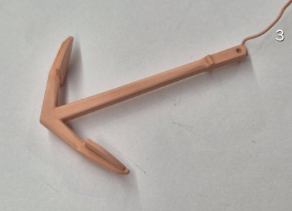

26. Preparation. I lightly sanded the surface of the plastic, removing the texture from the printing, only on flat areas. I did this because I wanted to apply a thin layer and didn't want the texture to be visible... but getting ahead of myself, I'll say it was still slightly visible. So, too thin a layer isn't good either, so either prepare the surface more thoroughly or apply a larger layer.
27. Fixation. I made two holders for each piece slightly longer than 4 cm. I didn't combine them into a single link and minimized the amount of metal. As I said, I drilled a hole and fixed copper wire into it without glue. When cutting, the end merges with the surface, and after polishing, this area is invisible. But it's still better to do this from below or, as I plan, in the gun holder where it attaches to the gun carriage.
28. The general holder is not dipped into the solution, but each part is screwed to it separately.
29. Current, Amperage. This is the most important thing. I set it to a little less than 0.2A for the first hour and then increased it to 0.22A for this batch of parts. But since the graphite wasn't completely dry, as I expected, crystals began to form almost immediately. Not as large as in the second test, but just as I wanted.

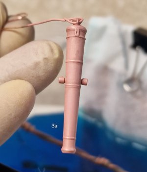

30. Time. Two guns and the anchor were coated almost simultaneously. Coating took 4 hours. Only on one gun, the ball on one gun lagged slightly, so I moved the gun closer to the plate at that point, and they quickly caught up with the others. Coating began almost instantly; after a couple of minutes, a copper halo appeared around the contacts, and then as in the photo.
I'll also post the results in the next post, showing them and indicating which test resulted in which.

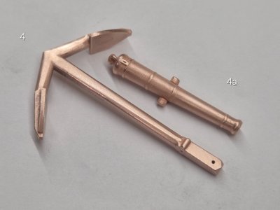

Test #4
This time, I also deliberately underdried the graphite to achieve a rough surface.
This time, I chalked a 55mm anchor and a 37mm gun. I minimized the holders. I started at 0.01 A/cm² because I didn't need to worry about crystals forming in the uncured graphite (I wanted them anyway) or about brittleness (strength isn't as important here). After an hour, I lowered it to 0.006 A/cm² to prevent crystal formation and keep everything under control. After four hours, I increased it to 0.007 A/cm², and after another three, I increased it to 0.01 A/cm². I rotated the parts so that the spots that hadn't yet closed were closer to the plates. There were three of these, each 5mm thick. I'll leave them overnight to build up a layer at a low current of 0.007 A/cm².
I have one final experiment planned – one aimed at replicating the overall result, or rather the one I'm interested in, to ensure repeatability. After this, I will draw conclusions and show all the results, and most importantly, this is the result after blackening, since this is what everything was done for.

33. Structure. When copper is deposited on graphite that is not completely dry, and even with high current, its surface and the layer itself become loose and very brittle. In a normal state, on pure metal, it adheres as a single unit. On fully dried graphite, with low current, copper also adheres very tightly; its structure is strong and it can bend within the strength limits of the underlying material.

Test #1 and #2
Left (1a) and center (1b) - Test #1.
The graphite was completely dry (3 hours). Therefore, the surface was initially smooth, dense, and very strong. Current 0.006-0.007 A/cm². The layer thickness was greater than 80-100 microns. The coating time was 6 hours for buildup and 24 hours for layer growth. Left - polished with 000 steel wool (which was sufficient). Center - polished with 0000+ steel wool, which produced a high shine, which is excessive for cast iron.
Right (2) - Test #2.
The graphite had not had time to dry, which is why "sugar" formed on the surface. Because of this, the surface is loose and weak. The current was too high (for the purposes of the experiment). The layer thickness was too large (not needed). Polished with 000 steel wool. A rough surface was intentionally left to imitate cast iron (but it was excessive).
Conclusion. (1a) would likely have been acceptable if I hadn't overdone the polishing, so I already applied the blackening to option (1b). I also didn't like the excessive shine and gloss. It's more suitable for forged steel (anchors, rims, hinges) than cast iron. I'll try to replicate result (1a) in test #5. Result (2) was close to what I wanted, but the crystals were too large, so I tried to replicate it in test #2 with smaller crystals.

Test #3
The graphite was intentionally left uncured to achieve a sugar-coated surface effect, but due to the low current, the crystals are not large (which is what was intended to simulate cast iron). The current was 0.009-0.01 A/cm². The layer thickness is minimal; there are some areas where the print texture is visible (this was done for the experiment). The buildup time was 4 hours, and the layer growth time was 10 hours.
Left (3a) - immediately after copper plating. (3b) Right - after sanding with 000-grit steel wool only. Anchor (3) - sanded with 600-grit sandpaper and then with 000-grit steel wool for smoothness and a forged steel effect. There are streaks on the guns. I intentionally created an uneven surface to demonstrate that the graphite layer must be uniform and even, otherwise there will be ripples.
(3a) I also polished it with 000 steel wool and after that I put it back in the bath for 15 minutes to copperize.
The gun was covered with a thin layer of new copper... but it was not enough.
I carefully went over the rims with SW 000, then blackened them, but more on that later.
I did the same with (3b), but I set it to re-copper for 2 hours, just like with anchor (3).
After that I got a surface like this, almost the same as immediately after test #1.
Without finishing (not polished), I blackened this surface: anchor (3) and (3b) for experimental purposes. I'll talk about this later.
Conclusion. The quickly grown sugar surface turned out well for the guns, but the anchor required some effort to polish. Re-coppering the polished surface very effectively removes polishing scratches and dulls the shine and gloss. But getting to the bottom of it, the top layer of re-copper plating must be removed before blackening, as it is brittle and susceptible to scratches. Light polishing removes this layer, and after blackening, the surface is resistant to friction. This time, the layer is much thinner, and this is noticeable in the geometry and weight.
Test #4
I didn't dry the graphite thoroughly enough again, to achieve a crystalline surface (next time I'll take the opposite approach. I'll create roughness on a smooth surface mechanically). The current was 0.01-0.008 A/cm², and I actually lowered it towards the end after filling the part. Because I didn't stir it, two internal points on the armature didn't close for a long time. The parts took a total of 24 hours to copper plate (due to the low current), but we have power outages, so I don't know how long the process took overnight. The layer is thin, so it's difficult to calculate. The coating has small crystals.
(4) After copper plating, the anchor was sanded with 600-grit sandpaper and 000-grit steel wool. (4a) The cannon was sanded only with 000-grit to preserve as much roughness as possible while removing the top layer. You'll understand later why I did it this way this time.
In this state, I copper-plated them again at 0.007 A/cm² for 2 hours (the armature (4)), and decided to leave the gun (4A) for longer. I hoped the texture would smooth out slightly from the printing, but the roughness wouldn't disappear completely. Unfortunately, the texture didn't disappear, and I remembered that I took this gun from the discarded ones (of which I have a huge number), so we don't pay attention to it.
But these aren't the final tests yet; there will be more... control tests. But conclusions have been drawn, and at the end, I'll summarize the most important points and write instructions for the best option for cast iron and forged steel... Until then, the next post will cover the most important thing... the purpose of all this copper blackening... and then the real results will appear.
