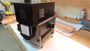

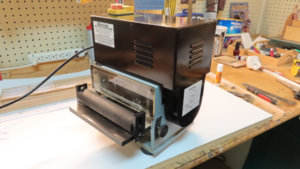

This is my review of the Micro-Mark Drum Sander.
1) First of all, the unit is VERY heavy (that is relative), but I did not weigh it, but I might guess about 50 lbs.
2) It is NOT going anywhere on the bench due to weight.
3) The unit came with A LOT of grease on it that had to be cleaned off. Do not run any wood through it without cleaning it. Grease everywhere and even on the main platter that the wood passes through.
4) The units adjustable platter (where the wood passes through) must be set up and made square to the sanding drum.
5) The unit has TWO Allen adjustable nuts with locking nuts on each side. The adjustable Allen / nut combo on the right side has a "cam" type nut that as you turn the Allen, the platter on one side raises. The overall height adjustment fine-tuning has about an overall 3 to 4 mm adjustment range. The nut combo on the other side is also somewhat adjustable, but the instructions say nothing about it. It does not have a cam, but a ball end on the Allen which if slightly loosened will allow for more leveling of the platter.
NOTE: on #5, this is not a science and you have to rely on your OWN judgment. There are NO calibration marks. It is trial and error of which I am not fond of. Trying to manually pass a piece of wood through the machine ALL THE WAY through with uniform smoothness is something you have to practice.
The above are basic facts. This is what my comments on it personally. I did try out the unit with several passes of wood. I have no previous experience with this type of machine. I finally figured out that since the DRUM sander was brand new, It had a tendency to grab and slightly dig into the wood making waves - every so slightly. HOWEVER, as the drum settled down with more passes, the wood samples started to be more UNIFORM.
I am neither happy or unhappy with the unit. It in some ways it really did not meet my expectations. The worst part of the design is the dust collection port is right IN THE WAY. They should have put the dust collection port on top, but it is right there as the wood exits out. Very annoying. There is a very heavy roller weight as the wood passes INTO the drum, but as soon as wood gets past the steel roller, then you really must be very careful about pulling the wood out the EXIT to pull out straight and even. They should have put a heave steel roller on the exit as well. There is a lot of engineering that could have been improved on this unit. I paid about $350 for the unit. but I simply could not afford the Byrnes or the Proxxon. The other units were about $80 to $90 more USD. The micro mark was ready for shipment, whereas the Byrnes had a 10 business day waiting period before it even left their place of business and I wanted to really get this project underway. With this said, let me repeat, that I have no previous experience with the drum sander and to SOME modelers it might be a great unit. I have nothing to compare to. I think as the unit gets more use, it will "settle down" and make good passes. One pass might be very close to the dimension that you are seeking, then if you pass the stock again, it might shave off a little too much. I cannot remember any dimensional specifics, but if I can try to remember each pass yielded about .0020 inches or .05 mm per pass. The best I could accomplish was about a +/- .05 mm as close to my goal as possible.
My MAJOR complaint is that Dust Port right in the way.

I read on the Micro-Mark catalog that someone made a comment that they were able to obtain about 1mm thickness or maybe less. The Steel Platter that the wood passes can adjust all the way until the DRUM is actually TOUCHING the steel platter. So, (joking here) - maybe paper-thin ??? if that is possible. As I continued to pass my billet planks through, it seemed that the sanding drum did not grab like it was, but was making nice even passes. They ship the unit with fairly heavy grit. You can buy other grits.
NOTE: Part of the problem is this. The platter DOES NOT raise and lower parallel to the unit. It PIVOTS on one end of the platter. This makes it a little awkward as when you are passing the wood through (and if the stock is some thin), then the wood will be passing on a Downward Slope. What is the solution? The design should be made that the DRUM is being raised up and down. This is usually found on large planners.
Some standard non-hobby planers I was looking at before this purchase, the platters had a minimum of about 6mm (these planners were found at large home lumber DIY stores. Not suitable for the hobby.
