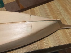

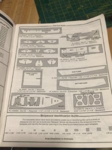

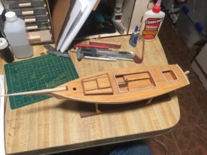

The instructions are good for a beginner level kit.
Pages shows all the laser cut parts and has chart to identify strip wood
This is a plywood skin on bulkhead built kit. It has balsa blocks for lower bow fill-Ins.B3899CFA-BD00-4895-8E54-51CA8F84EE6C.jpeg

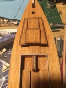

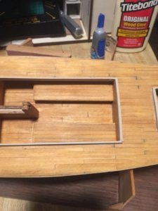

It has taken me a day or so to review instructions and work completed on this ship.
I noticed that I had changed not only the seats in main hold but the top of front compartment and hatch
It looks like I also covered the roof and hatch with planks and trimmed with walnut.
When I was building this with the local club my coach and adviser said to always look for ways to improve on the kit!
So i guess it did just that!
Kit shows a plain flat roof and hatch that was painted.

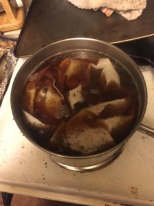

Also today I made a very minor piece of installation to get going.
It was not much but all I had time for.

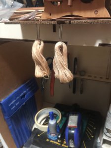

I drilled and installed an eyebolt into the top of centerboard for attaching line to raise the board.

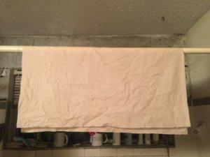

Also I tried something I hadn’t done before.
The kit came with two spoils of white thread for running lines. Instructions said to dip in mixture of tan paint and turpentine to darken to look like manilia rope. So I decided to use another process I had Learned in past.
I boiled up a pot of hot water and added several tea bags to get a dark colored tea.
After unspooling thread in a big loop around several fingers I used a clip to soak the thread to give it a darker color. I liked the result and then places the provided sail cloth in the tea soak and boiled it for about 5 minutes till it soaked in colors and lost stiffness of new cloth.
Photos show loops of dyed rope airing out and drying and sail cloth in pot and hanging over shower rod to dry.
Next step when rope is dried well to run thru bees wax to coat it and roll back on spools for use when needed.
I did this now as I need a 4” piece to tie up the center board before moving on with instructions

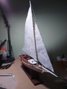

It's a great little project. And a lot of fun to build. Did this one last year. It's what I used to get back into wooden ship modeling after about a 20 hiatus.
Your correct it is a great small easy build. Looks like you built out of box and painted as listed. I am not sure if I want to leave the wood sides above deck and sides of bow sprint plain wood or paint.
Aug 16, 2019
591
308
North Carolina,United States
Yes I did pretty much do it straight out of the box. I liked the color scheme so I opted to do it that way. I was going to add some dredging nets but decided I wanted to move on to other projects.

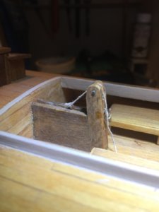

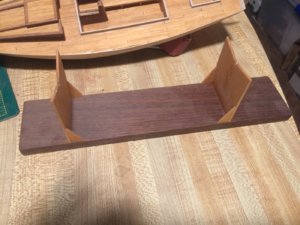

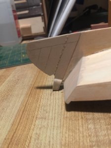

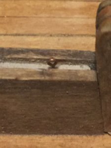

Today’s work was to install the first minor bit of rigging.
I added the retraction rope for the center board starting at eyebolt installed last night and over roller to clear on aft of centerboard frame!
Then I attached the lower section of center board. I used some wood stock and clamps to keep it centered vertically while glue dries

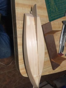

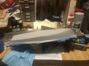

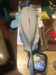

Progress of last few days was to decide on paint theme!
I bought Antique White for masts and yards and upper hull.
I have a medium brown for trim work and strip on hull.
Found spray can of dark cardinal red for anti-foul on lower hull.
Had to go with what I could find at local stores that were open!
Then I started painting mast and yards for topside.
I have the hull some wood putty for minor gaps and scratches in plywood hull and sanded.
Next is to prime and check hull before painting.
Last on list I found in the project box where I bought some wooded blocks to replace oversized plastic blocks. Now I have to add stropping lines to blocks to get ready for use.
Lots of minor prep work still before final assembly begins

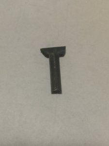

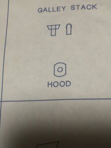

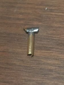

Ok while working on hull sanding and priming paint to dry I have stayed busy with other little bits on project.
My first thing was to upgrade cabin stove vent.
The instructions call for 1/8” dowel with paper hood glued on and painted.
I knew I could do better so I picked up some 1/8” brass tubing and package of thin brass sheeting from local hardware store still open
I taped hood design and cut shape from .002” shim stock. Then formed and soldered it to tube. After some clean up I gave it a bath in brass blacking solution to make it look like real stove vent.
Photos show pattern, new part before and after blacking. Some of solder didn’t fully blacken but I am happy as you will have to look under the hood to see light spots.
209898D1-FAD2-4A64-981F-223E41ABA7D2.jpeg2CF20829-BAF6-40B9-B1B5-C751C0AAE6A5.jpegDACC32AA-1B77-45D8-9623-CB321F3A584C.jpeg

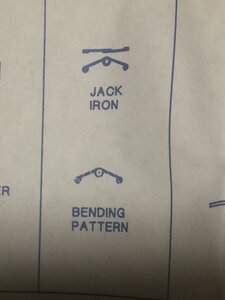

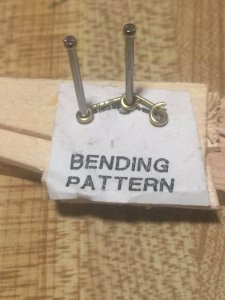

Next on list is part for job rigging a V shaped wire with loops. I am on second try as first didn’t come out too good. I got more .032 brass wire while getting the tube to try again
4805690C-6F05-4CB5-A795-C6585A461E97.jpeg2D12F350-573D-4522-B2E3-31693B8D8B3D.jpegF76262C4-6B3C-4ED5-B5BC-5AF13EAAABF9.jpeg
