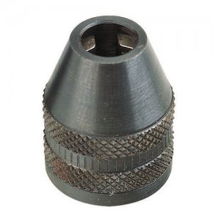

I sent an E-mail to Proxxon and this is their reply.
Hello,
The 115 Volt version and the 230 Volts version are mechanically identical.
The difference is in the electrical system, motor, circuit board, and power cord.
The keyless chuck # 28941 will fit either model.
I hope this answers your question.

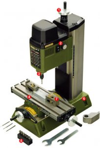

I have just purchased a MF70 and I love it.
I am a wood ship modeler. My friend, also a modeler has the exact same mill purchased in Australia. My Question is: Is the threads on the A mill from The US the same as one from Australia?

So they do sell the 28941 in Australia, becaust it fits other tools, metal Lathes, grinders etc.
https://www.hobbytools.com.au/proxxon-micromot-keyless-chuck/
Also you might not find the other Chuck listed anywhere except Australia. The owners of Proxxon World are engineer and I believe do a lot of research. It might not be a genuine Proxxon part

I think I know the answer to the Chuck.
http://www.proxxonworld.com.au/content/new_2015_2016_products_in_stock_at_proxxon_world
It says
New Relativity 3-jaw chucks 44001 for collet-type drill/grinders and Flexishafts suits 28440 - 28500 - 28510 - 28481 - 28485 - 28620
MICRO-miller MF 70/CNC-ready 27112 - MICRO compound table KT 70/CNC-ready 27114
Proxxon World
Fine tools business unit of Relativity Pty Ltd
Looks like it is not a genuine Proxxon Part but a Relativity Pty Ltd part

I talked to the Proxxon rep today and He assured me that the Proxxon MICROMT 28941 Will fit any MF70 mill. I can get one from Amazon.com for $11.37 free shipping. I ordered one and when it comes I will let you know how it goes.
:music-rockout: :handgestures-salute:
G'day Mike the Proxxon Chuck 28941 will fit on the MF70 I used to use one on mine,
best regards John.
Ahoy Ship Mates,
My Proxxon MICROMOT Three Jaw Keyless chuck arrived today. I opened the box put it on my Mill And it works like a champ.
The only difference in this chuck and the original equipment is this chuck doesn't need collets. ( or a key R..R..R...earth humor) :cool: :music-rockout: :handgestures-salute:s-l1600.jpg
