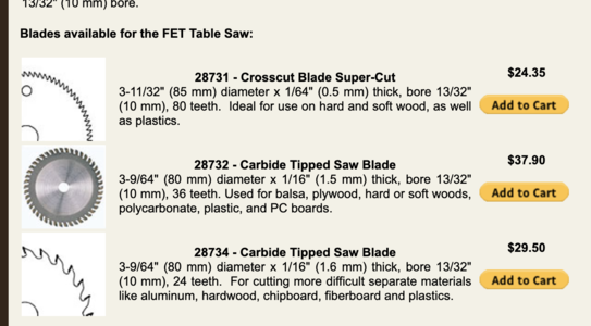

Is the supplied blade carbide tipped?
I saw a previous post where someone recommended a 36 tooth tungsten blade. What would be the difference between the 24 and 36 teeth? Cleaner cut?
Higher tooth count typically gives a smooth cut and are generally used for cross cutting. They are also used for less tear out on plywoods and laminates. Note the feed rate is a bit slower. Lower tooth counts are better for ripping. One other thing- there are several different grinds typically available.
Carbide tipped blades way outlast standard steel blades. They can also cut through non-ferrous metals like brass, copper and aluminum.
Thanks Phil. Another question: the table saw comes with a 24 teeth blade. I also see other blades with a greater number of teeth (see attached). I will be making some fine cuts, e.g. 45 degree angle cuts on 2 x 5 mm strips, etc.. Do I need another blade in addition to the 24 teeth one?Screen Shot 2022-05-21 at 11.41.43 AM.png
