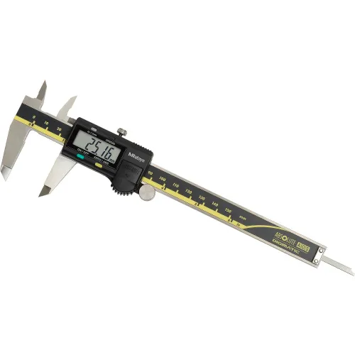

Alright, folks. This is the last posting in regards to the Mitutoyo real deal. Monday, I have received some gage blocks. 50mm and 10mm from China, while 95mm, 5.0mm, and 1,08mm from Russia. The Russian gauges have a mirror-like surface, their Chinese siblings - mate\glass finish.
So to the actual tests. I will post series of images where on the left will be fake Mitutoyo and on the right the Real deal. We will start with a 95mm gauge
Now a 5.0mm gauge
now a 1.08mm gauge
the last test on the 50mm gauge block.
As we can see, in all tests a fake instrument fails to measure the exact readings, while Mitutoyo does read all gauses correctly. Yes, the difference in reading a quite small, but they are persistent for all gauges. To see how much difference it is, the last measurement I made in an imperial system.
50mm = 1.9685 inch (decimal). See the results.
Well...I hope this was an informative and educational topic. It is in no way a recommendation to buy only Mitutoyo calipers, there are many other reputable brands for measuring instruments, the choice is always yours, but...if you make a decision to buy Mitutoyo - buy only from their distributors. You will have peace of mind, and a lifetime precision measurement tool.
thank you for all your comments and likes!
I calibrate these for a living as an aerospace quality tech. I knew the fake was not real right away. The word "absolute" was not on the removable battery cover and the serial number decal was not correct , plus the missing fourth digit in the display gives it away. . It's amazing how close they can get them.
