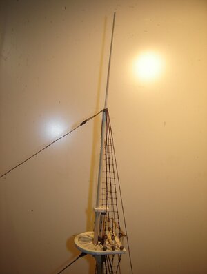

That looks great. It looks like my scarf joint turned out well and should work for this. Better that remaking the entire mast anyway. Did you already have a drawing for a 29' mast or did you adapt one to fit. I'm beginning to think that you are putting way to much time into my ship. I sure appreciate it though :)
The masts are proportional so I just enlarged the Investigators 26' mast.

So now I'm back to where I was before I stared this thread but with the right masting. I was concerned that I was going to have to redo all the shrouds and ratlines. I pushed out the fid and dropped the mast and all the rigging slipped off the top just like a real ship. I had to slacken the backstays and stay to get the new mast back in but everything seems to look as it should, I think. Holler if you see something wrong.
