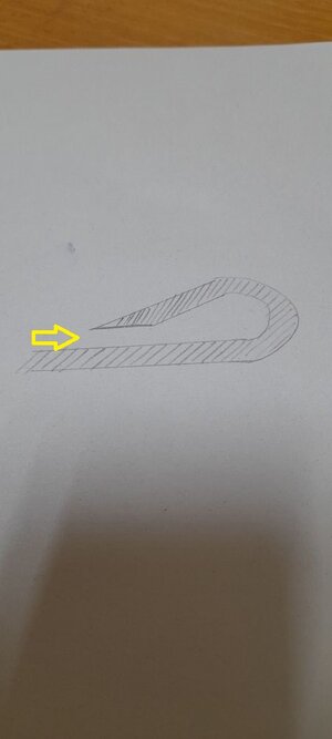

Hi, Alexander, could you please describe the method you do your eye splices? I am interested in whole process including rope serving.
Good afternoon. I'll try to explain. I learned this method from Dmitry Shevelev. First, the rope must be completely braided. Make a loop and cut the rope at an angle with a sharp knife. Apply the cut to the main rope and glue it with a drop of CA. Then cover the gluing area again.20231201_090817.jpg
