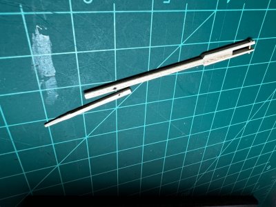

The hull has been primed and is now drying. I will next sand it and paint it. While I am waiting to paint, I have been working on the tiller and re-reading the next steps. This is where I feel the instructions are very confusing.
I have joined the three tiller parts and installed the pin in them. I don't have small hammer so I grasped the pin in the jaws of needle nose pliers and hit it with hammer. I think that served the same purpose. Question is, am I supposed to use same 1/16 wire for the tiller extension? Seems extension is too narrow and will split.

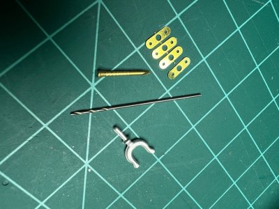

Next I started looking at installing the various hardware pieces. I found it confusing as to which photo etched brass pieces were what. So I took a picture and then went through directions and labeled them as I see them. Here is the picture. Do I have these correct?
20250325_152100.jpg.
Thanks for looking.
I believe you have those correct. I found that most of the holes were too small for the parts and nails and had to be enlarged. A few of the items like the oar locks I just glued into place using CA.
Rob

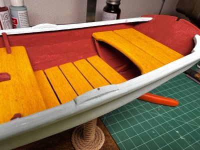

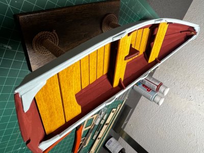

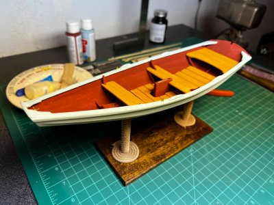

The Pram has been painted and I have started installing hardware. I installed the stay plate on the bow transom. I used a Dremel cutoff wheel to cut the brass tube to simulate the hex nut. Much easier using Dremel for this. For the two stay plates on the side, I merely glued them in the slots using CA. What is the best way to open up the holes in the photo etched parts to accept the brass nails? I got tired of messing with those little pieces that I would switch to working on the mast. I glued the two halves of the square mast and started assembling the spar shaping jig. Of course like everyone else there is a fifth notched piece that is missing. I will try to make one from the scrap wood. Did others do this or just omit one and if so which hole did you leave empty?
Here are pictures of the painted hull.
When the directions said to check measurement at the widest point I measured exactly 3 3/4" from the outside edges of the sheer strake. Usually you would expect to do some minor sanding to fit. I have a Drexel scroll saw that I can use to cut them quickly but afraid of cutting them too short. I'll try to file them. For the stern sheets, I'll probably have to build up the knees to keep everything level.
I had to shim to get the stern sheets level. Wasn't a big thing and it looks good now.

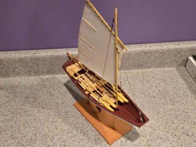

Here is a picture of my sail lashed to gaff and boom. I used a non-stick cookie sheet to make the sail. unfortunately the sheet had some small cuts in the coating which resulted in some small rust stains on the sail. Oh well, sails out in the weather will get marks on them. Notice the extra line needed to stretch to the holes in the gaff and boom.
Here I am in the process of rigging the stay lines. Once I get the loops in the lines glued and everything adjusted, I will go back lash some tan thread around them.
I'm getting close to the end. Hang the sail, touch up painting, and staining the stand. Oh, and did I forget the oars. I'll be up sh..t creek without a paddle.

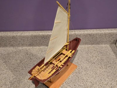

I have completed the Sailing Pram. I am not completely satisfied with how it turned out. My initial rigging of the stays resulted in the boom just about resting on the tiller. I was able to redo the fore stay to lean the mast forward just a little. To lean it more would have required redoing the back stays but I didnt have enough of the 0.7 line to do these.
My next project will be the Lobster Smack from Midway kits which I accidentally ordered. Probably start that in June. In the meantime, I have some model railroad projects work on. After the Smack, I have my mind set on the Occre Albatros kit which they label as a kit for beginners. Doesn't look like that to me but I very much look forward to tackling it.
You did a great job in my opinion, including realizing and not being completely satisfied when something was amiss. Looks like you are ready for those bigger things :)
