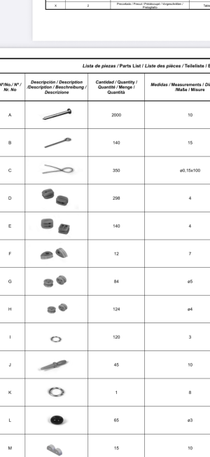

Hi Bill,
In the instruction you have the total amount of every blocks and deadeyes that supplied with the kit.
Those are the amounts also take the notes that i wrote in privet and add them as well.
If you planing to use only long guns calculate as necessary you will need 4-single blocks and two double blocks for each gun if I remember correctly.
Thanks again Guy. I have not open the kit yet to peek at the supplies. These you show are like the ones OcCre supplied with the Amerigo Vespucci. The blocks are 4mm single and double. I thought I saw in your supply photos that you purchased various size blocks.
Yes,I changed all the blocks and deadeyes to better quality ones from dry dock models and parts the blicks are from pear and the deadeyes are from ebony.

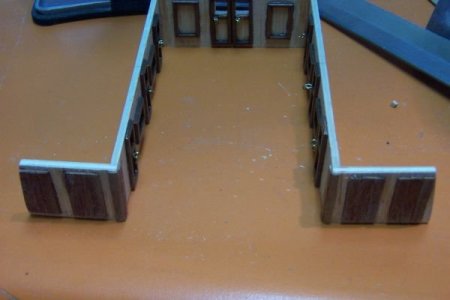

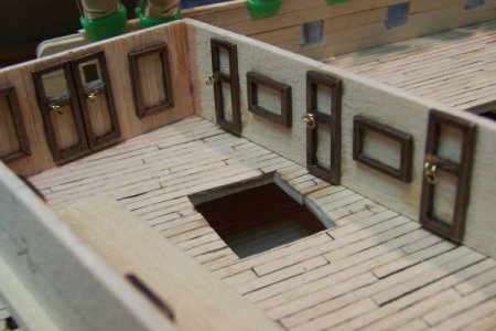

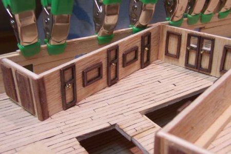

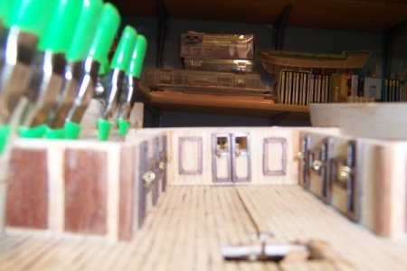

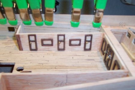

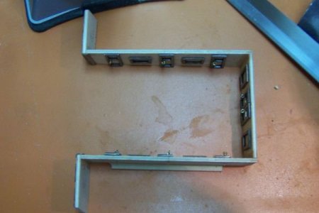

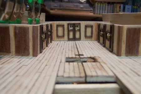

Yes I remember all of the detail work of those bulkhead hatches and etc. that will NEVER be seen, except by the model maker. Here is my work on the same bulkheads, I choose not to paint them.. Great job so far, good decision on upgrading all of the blocks, I have also boughtt many blocks of diiferent sizes and etc to use if I do not like the parts that are included in the kit.
