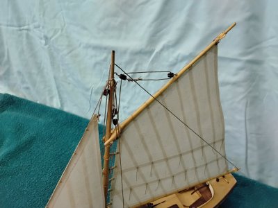

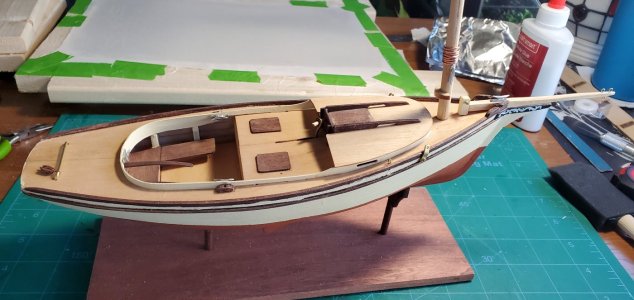

I have been working on my ship again. I have installed the eyebolt on the bow, the traveler, tiller, fairleads, installed and painted the trail boards, shaped and installed the bowsprit, made and installed the chainplates for the backstays according the the instructions, installed the cleats but choose not to paint them. I shaped the mast, boom, and gaff sanding to create the four square, then the eight square and finally using a vise to hold them and sanding them round. I have installed all the hardware on the mast, boom, and gaff according to the plans. I created the 7 stropping blocks. I am currently working on the sails.

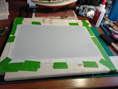

When I stiffened the sails on my Pram I taped them to the cutting mat and painted them with the glue/water slurry as per the instructions. I was unhappy with the results because the side that was against the mat dried smooth unlike the opposite side which had a nice texture. This time around I built a frame and suspended the material. I am much happier with the end result.

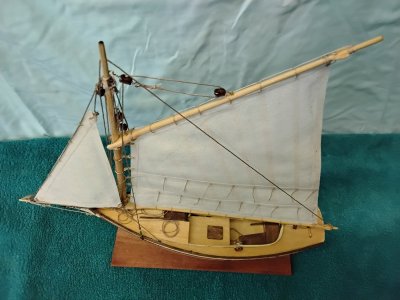

All thats left is the rigging.

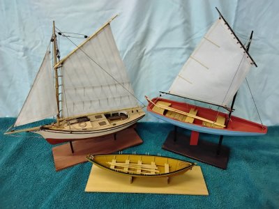

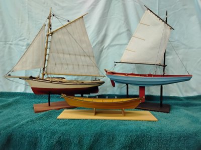

I have finished my final boat in the Model Shipways Shipwright Learning Series. It was a very enjoyable experience. I learned a lot in modeling. I am happy with the way all three boats turned out. Thank to SOS for this forum, it was very insightful and my boats would not have turned out half as good with out the help and insight given here. I am not sure what ship I will tackle next but there will be something in the shipyard before to long.
