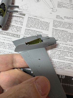

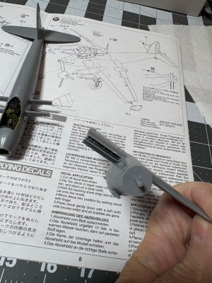

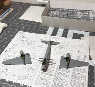

Update on the Mosquito…
Building the main wings. About 7 parts each and some pre-painting in the hard to reach areas like the wheel bays and the radiators.
Next they will be glued onto the fuselage.
I am not working in exact order per the instructions. They have you complete each wing with landing gear, gear doors, pylons, bombs, etc. …which makes no sense to me! You need to paint the aircraft first, then add all of the other components. So I read the entire instructions and made note of what I needed to assemble and pre-paint in order to be ready to paint the entire aircraft.
See ya next time…
