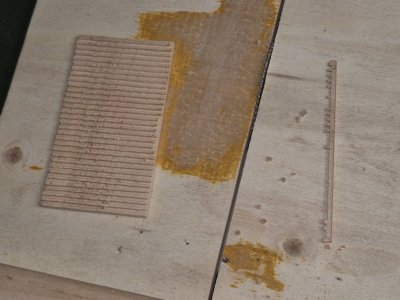

Well, sorry, I have already started, as I did not know what was coming in the kit from the Lumberyard, and first up, turned up and also made the gun carriages, the 4x4-pounder cannons, and I will use them in this build: 1:48 scaled cannons from the Bounty:

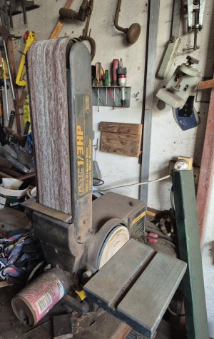

Had this sander for many years now. It's a godsend for sure!
However, I had to make modifications to the top idle shaft as it was always running dry, and, after rectifying that, it has worked a treat.
Note the Can attached, that is the outlet for the vacuum to attach to, as I was in a hurry and did not want to go downtown and buy an adapter. Works a treat and never bothered to buy the proper part.

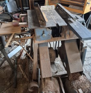

This very old bench saw, complete with a 4" Planer, I did for a trade for a job to fix a small sailing dinghy. I have heavily modified it by using larger 3-phase motor/s, one 2.5 horsepower (Overkill) for the Saw blade operation, and also a 3/4 horsepower motor for the planer. The arbor for the saw is only 1/2" in diameter! I don't use dull blades and sharpen them myself.

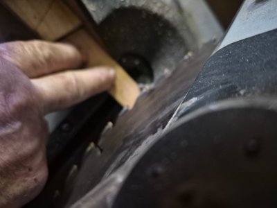

The drum sander on the LHS is what I have used to make thin wood pieces over the years, and it works a treat. With any drum sander, the trick is not to take heavy cuts and clean the abrasive regularly.

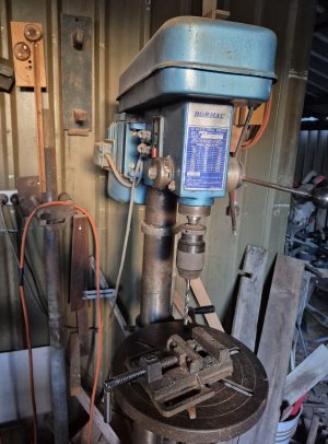

Pedestal Drill with a 1/2 inch Jacobs chuck (hand-tighten) but can take a No. 2 Morse Taper drill bits, etc. Had this since the late 1980s, and what it has not done is not worth worrying about. Bearings and the whole unit are in excellent condition.

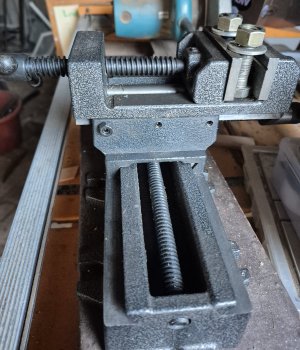

I have recently bought this X-Y vice, and that is such a blessing as well .......

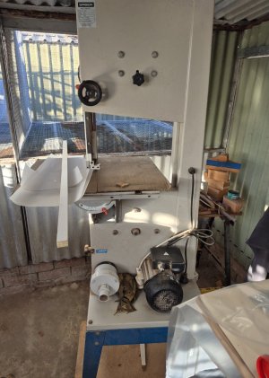

This next item is the 10" Bandsaw, and I bought that in 2018 to help me make Didgeridoos, as I thought a great idea, but no one wanted to buy them, so I stopped making them. They took about 5 weeks for a didgeridoo to be hollowed out, decorated, painted, and varnished, and were very labour-intensive.

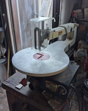

The next is a Jigsaw by Jet, and I just bought that about 8 years ago. Seems to work quite well, but takes a bit of skill to operate. I would like to use it to cut the frames. I am spending a bit of time practicing cutting material with it first. I think the bandsaw has its problems too, but I will see.

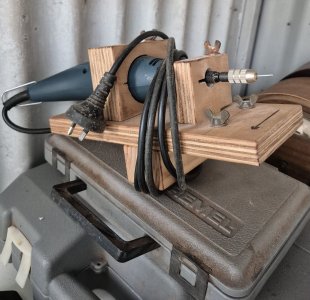

I found that a Dremel is ok, but they can die as well but a Ryobi is much cheaper to buy and does the same type of work, and the tooling for the Dremel fits the Ryobi also.

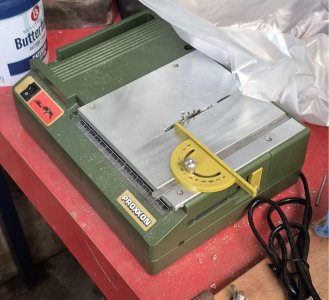

Proxxon Saw bench. It cuts well, but the Tee slide is absolutely useless for cutting on an angle. I may stick some emery tape to at least be able to grab hold of the material I am cutting at an angle.

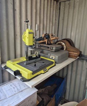

With the drill press and with the x-y vice, I will attempt to make the "Lazy Susan" to mill the Helm Wheel up, as I think you sent me an attachment showing how to do it. I think that would be a fun project to do.

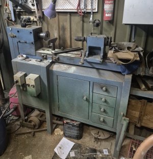

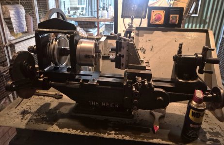

I do have in mind to machine up a spigot and a faceplate to locate in a bearing hole mount, which will be fitted to the X-Y vice. I do have a Machine lathe, although very old can do many things as I compensate for its weaknesses.
Here, I have it set up to do milling work. The machine is a lifesaver for me. It is nearly 100 years old, and it has a name, and that is "Arnie", after Arnold Swarznegger from the Terminator series, where his body keeps on being renewed with new metal. LOL

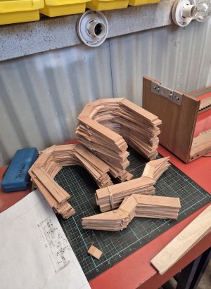

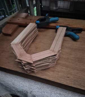

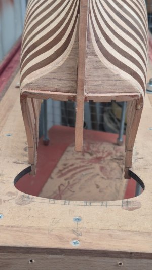

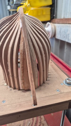

So, all, I have done a bit of work on the model and have built all the frames, well, the fitting of the rough shape outlines of the frames at least. At first, and on the first set of frames, I blind folded myself when I built them. There were a few slits where the wood sections did not quite fit together. Then after that, I used my cutoff saw and, with clamping, had great success. First, I used the Proxxen Saw, and cutting at angles proved to be very challenging to set up and maintain due to the slight movement of the wood stock against the angle of the blade. Here they all are.

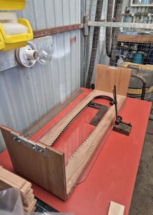

So, after finishing the frames, I took a look at the Framing Jig sent to me, and it seemed to be so accurately made, it was a wonderful experience to have this jig made, as I thought it would be a huge stumbling block for me when fitting these frames and keeping the angle smooth and true.
I spent a fair bit of time searching here on SOS and also on the web, and one of the members of SOS had included a video on how a certain individual had advanced the Harold Hahn build in regards to how to use some clever ingenuity to help make building the ship's hull, little easier.
I am going to follow similar lines with this build, following engineering and also the techniques of old to accomplish the accuracy of the hull shape.
So, what I have achieved so far is to find out what height the frames will be, and I have added a centre line X-Y bracketing that can be moved if needed, and then I lock it into place once it is correct. A weighted string line will be attached, and that will be how I keep the alignment of the frames tracking correctly, hopefully.
Although not shown in this photo, I will include the teebar and slots to accurately hold the frames square and true.
For the jig to sit and lay straight and flat, and after checking the table for bumps, I laid a piece of glass, 6mm thick, down and carefully checked for flatness, and is certainly flat enough to not cause any hindrance to the build.
I am also going to have a clamping system fitted to the end of the framing jig to hold the keel and bow section in place, so I can learn to work around this and not destroy the model with overexertion if that comes to mind.
