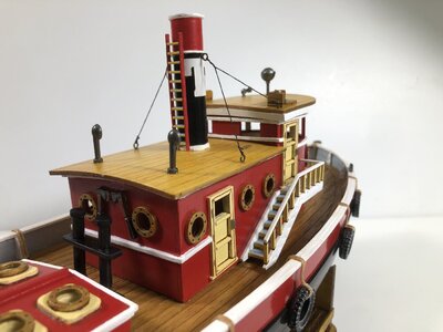

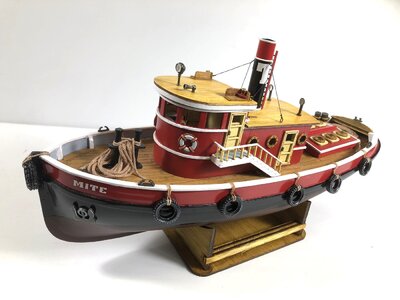

Ok Guys,

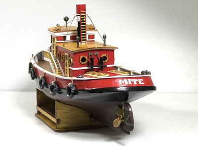

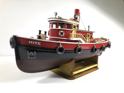

Here is my building log about this little “Tugboat That Could.”
Model Expo commissioned this model to me and it will be exhibited at the Las Vegas 2021 NRHSA CONVENTION & TABLE TOP EXPO.

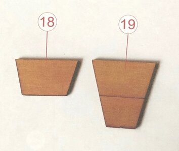

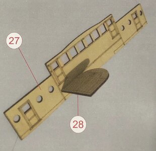

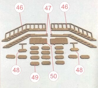

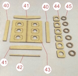

So, you will have to excuse me because I will use a few pictures from the instructions manual.

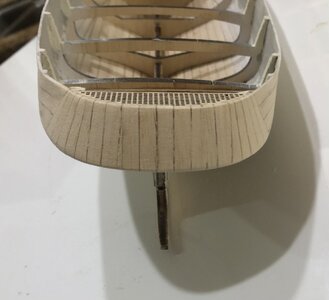

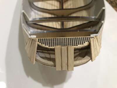

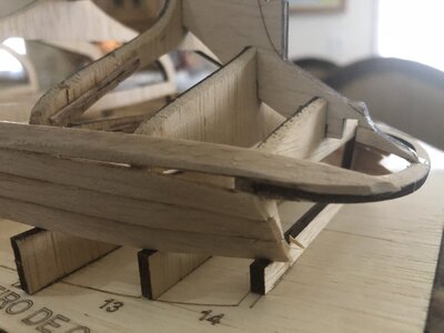

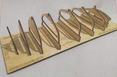

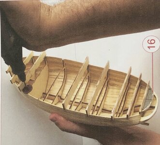

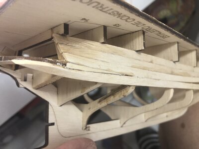

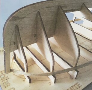

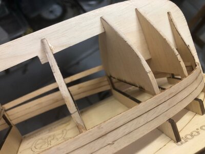

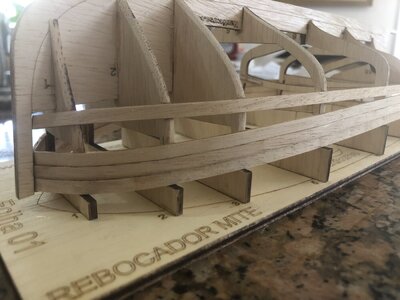

The kit comes with a building base where ou attach all of the frames.

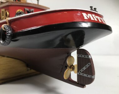

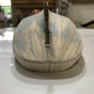

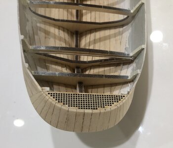

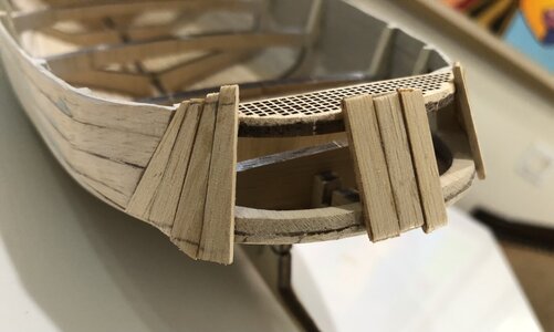

After to cut off the upper frames sections is was time to close the stern y cutting small pieces of leftover plank and glue them in parallel by tapering each plank.

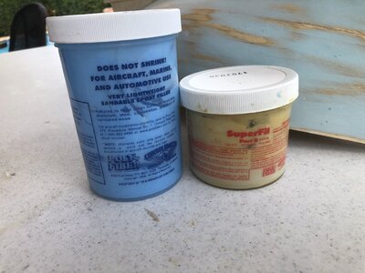

After that the hull recived a coat of Super Fil by Poly Fiber. I love that stuff.
IMG_0413.jpgIMG_E0350.JPGIMG_0352.JPGIMG_E0355.JPGIMG_E0356.JPGIMG_E0353.JPGIMG_9515.JPG

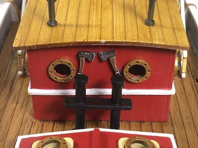

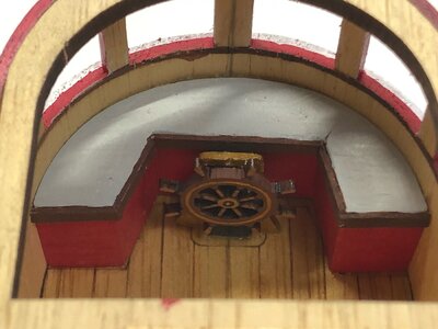

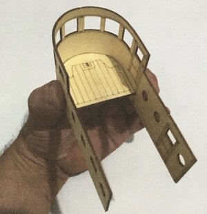

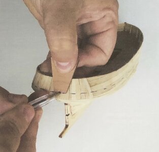

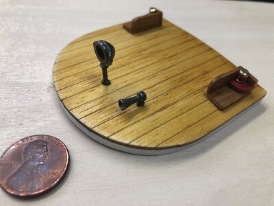

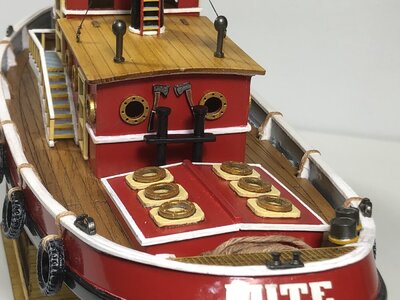

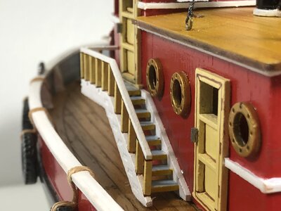

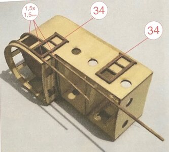

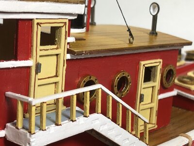

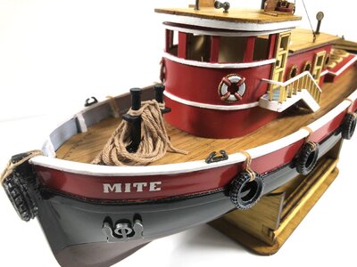

Assembling the Pilot House was an easy chore. I let the main wall soak in my Jacuzzi for 20 minutes and it was very easy to bend into shape.

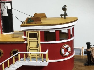

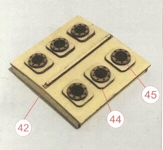

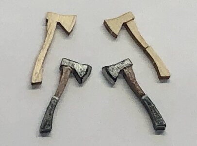

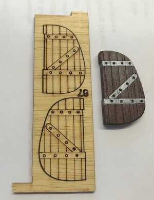

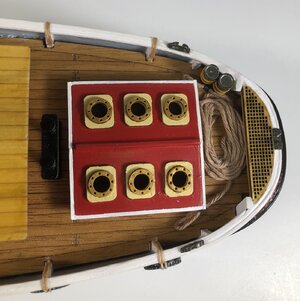

The engine room cover was also an easy task, but the detailing in the paint took me a very long time.IMG_0417.jpgIMG_0418.jpgIMG_0419.jpgIMG_0420.jpgIMG_0422.jpgIMG_0454.jpg

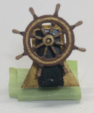

I overengeenired many parts of the model but that is just me.

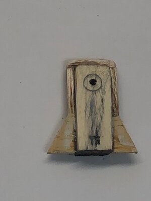

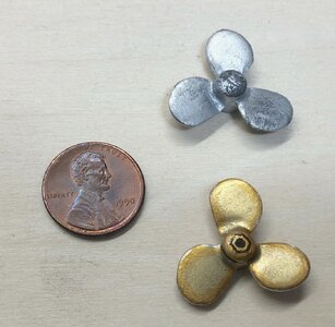

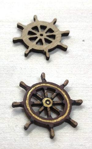

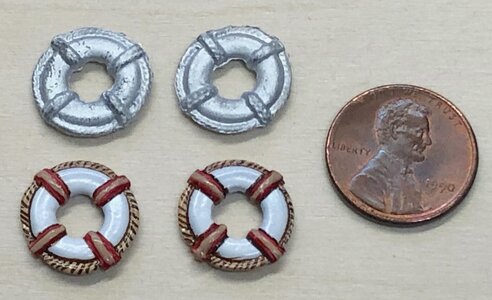

The metal parts where very difficult to file into shape because the maker didn’t use Brittania metal but something else extremely hard.
View attachment 253908View attachment 253909View attachment 253910View attachment 253911View attachment 253912View attachment 253913View attachment 253914View attachment 253915View attachment 253916View attachment 253917View attachment 253918View attachment 253919

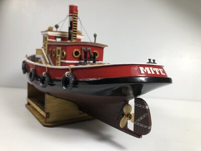

I really like the detailing. I wish I had your pics while I was building this. Great work!
Barry is the other way around.
You inspired me to do what I did.
We could have add more details but on my case, I didn’t have enough time.
