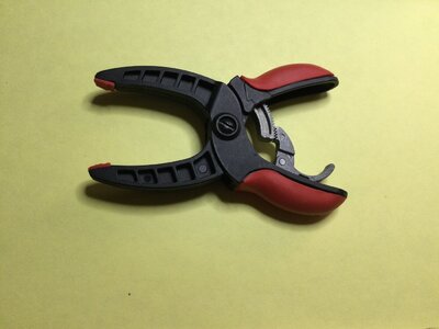

I used these when I build the lifeboat for my Tug
I padded the jaws with blue painters tape and a layer of wax paper and fit them around the bow. I applied just enough pressure to hold the planks in place. Don’t know the size of your build, but it might work for you also.

Where did you get this clamp? I did a google image search and didn't find anything.

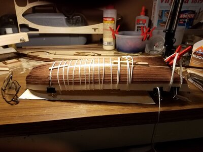

I can tell you what I did. I used a strong cord or string to wrap around the ship. Straight across and diagonally to hold pieces in place. Then where needed I would slip small scrap wood under the string for more force. You can also use nails but I found they don’t hold as good. Hope this helps.

Nice looking clamp. Can you tell me the brand name? Thanks
