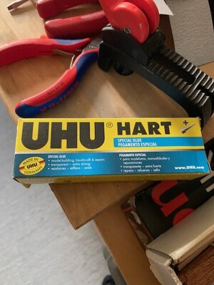

Hi Marty, I have the same "problem" with glues. There are so many and I have to find out what kind fits best for me. For the deck planking white glue was not working for me because it took so long to dry and I accidently shifted around planks. I did it with contact glue and destroyed a hand full of panks but there were enough in the kit. I don't know the yellow white glue but this seams to dry much faster. At the moment I think UHU hart is the ideal glue for the deck planking for me.
