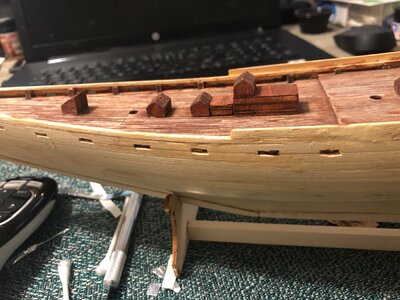

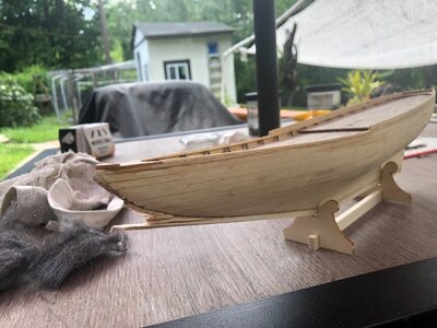

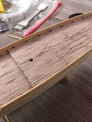

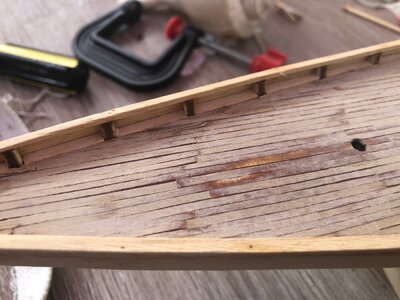

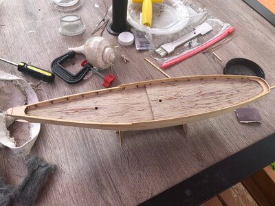

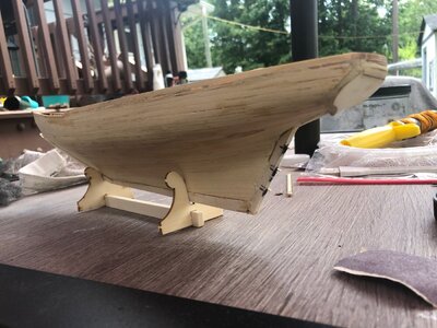

Good day. I hope I placed the post in the proper place. This is my first post relating to an actual build. In looking at the many photos I see here, I am SURE I did a few things WRONG, but I am new, and I will learn. Here are the photos of the build thus far: I hope they show on the page. I am building the Billings Boats Bluenose II. The directions said to mark the deck using a pencil, but I went the extra step by laying my the deck plank by plank.
Hello, fellow Bluenose builder, nice to see another Billing Boats build.
That's some real TLC that went I to the deck, lovely. Did you already scrape the deck with a sharp razor blade to even all the deck planks?

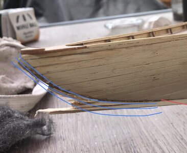

I hope you don't mind, but I saw some details you might want to improve upon.

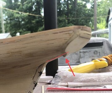

At the transom/stern you might want to fair the aftmost part in line with the hull planks, so the planks and transom are flush relative to one another.
A second detail which caught my eye was the bow section. Did you have some accident, where the bow met something more solid? If you need to repair this, my approach would be to use strips of 1mm (0,038" thickness and as wide as the keel is, use any method of plank bending you're comfortable with and laminate until you have the required thickness. Then some sanding and filing and the bow would look as new. Oh, it would be best cut of the present keel beam where it's still undamaged and maybe introduce a scarf joint between keel and the repair.

THANK YOU for the reply! Well, to answer your questions, the "transom/stern" piece - I DO plan to make that flush. The Bow section is still a work in progress. I did what i could to chisel off a piece long enough to fill that section, but, it was installed a little crooked. I DO plan to fix that. I REALLY appreciate your feedback! As for the deck, I bought a plank slicer from MicroMark and sliced decking from a very thin piece of (birch?) I sanded it all flat. What I want to do is fil the spaces between the planks with something black that does not make ALL the planks look black.

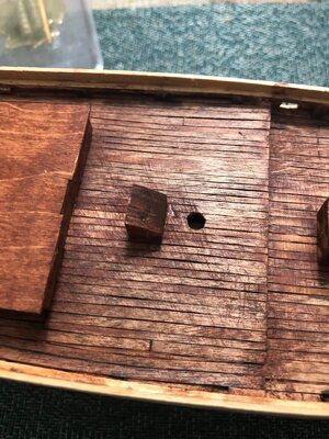

If the deck planks are already bonded to the rest of the hull, this blackening will be tricky at best.
Having gone through various build logs, there appears to be three main options:
1. Do nothing, plank as tight as you can get it. Especially the smaller the scale, the more out of proportion the other options may look. At 1:100 of your Bluenose may fall well within this range.
2. Bond black, thin paper to the one edge of the planks. After bonding, scrape planks and paper flush. With larger scale ships this may be a favorable solution.
3. Mark one edge of the plank with a pencil, hardness B or HB appear to give satisfactory results, although a friend of mine had issues of smearing the pencil over the deck surface when he applied the final finish.

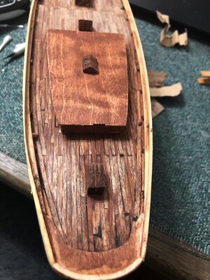

Bluenose Update!

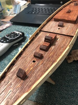

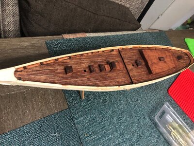

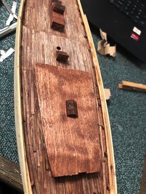

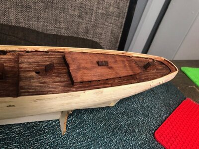

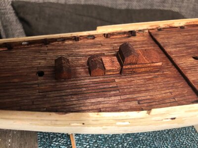

I added the deck parts, and I applied the stain. It's a little dark, but the black "tar" between the decking came out nice! (IMHO) What I ended up doing was taking some white glue and adding black pigment and thinning it with water. I used a paint brush to apply it and then sanded it down.
After I applied the stain, I sanded out the obvious coarse sanding marks that the stain highlighted. I also gave a shot of the scuppers I cut out of the forward deck.
