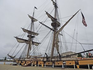

wife and I took a 5 hour sailing cruse aboard the Niagara
here are a few fun facts

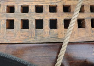

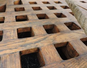

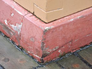

the corners on coamings are not like a 45 degree like picture frames they have a lap joint

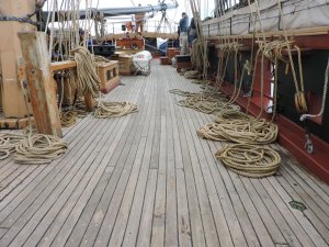

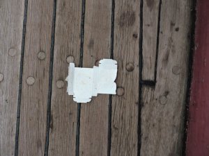

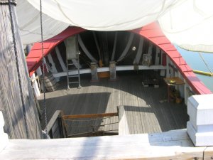

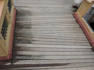

many model builders plank their decks in stark white Holly actually the color of a deck is far from white. I took a raisin box and opened it up flat.
decking does not run straight it follows the curve of the ship
the deck planking at the stern meet in the middle as a wedge shape

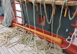

there is a statement from forums "the inside of the bulwarks were painted red so sailors could not see the blood" WRONG the inside of the bulwarks were painted green. I did ask the historian in the museum about it and she said from records there is no reference to red bulwarks red if used was as a trim.

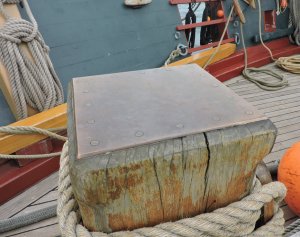

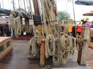

does anyone know what the pole sitting on the waterway is?

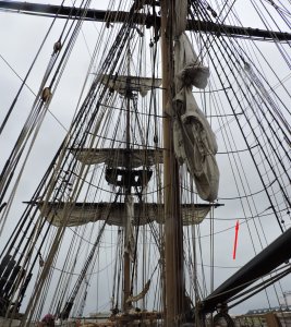

did you know the ratlines were tied to one another the red arrow shows the line

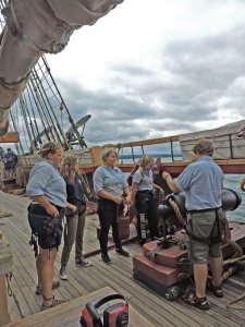

by the way guys the ships crew were well see for yourself
even the gun crew

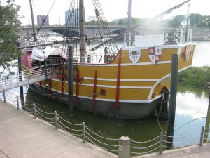

the Niagara 1812

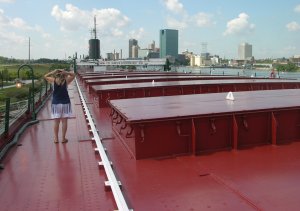

and Evelyn who owns and runs the lumberyard for model shipwrights she sailed the lakes from a 1,000 foot ore freighter to the Niagara and has been
aboard many a wooden ship

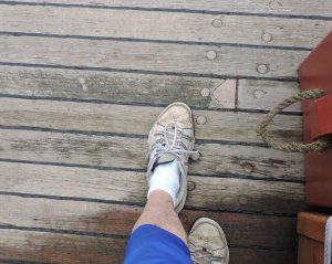

Also look at the withd of the planks on the decks,most kits gives you at least 4-5 wider timbers for the decks,completely out of scale.
good point I was just telling dave on his build deck planking was close to square in cross section.
you are not going to bend planking edge wise to conform to the hull shape BUT you can bend a deck plank if it were 4 inches wide and 2 1/2 inches to 3 inches thick
that is my shoe and when I measured the length of my shoe it is 12 inches so a deck plank is 4 inches wide
deck planking on most all ships in North America was Southern Yellow Pine
it only takes a few months out doors and wood will turn grayish silver

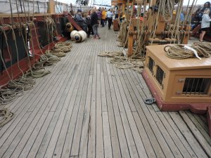

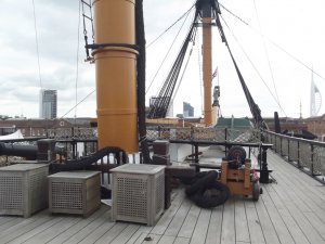

It depends realy very much, where the ship was build and which kind of timber was used at this time.
Also the width of planks depends on the tree, from some sorts you can not cut bigger widths in enough length and number....

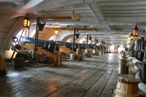

If you compare the deck of the Victory you can see, that the width of the planks was much bigger, than compared to the Niagara

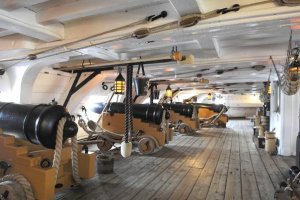

here the gun deck
HMS Victory 32-Pounders on Lower Deck (5).JPG HMS Victory Gun Deck General e vers_2.jpg

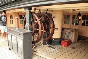

and when we go outside you can find the same width (but looks like to be restorated)
if you compare the colour of the planks ...... photo with steering wheel is weather protected, and in the following unprotected - it appears much lighter, and grey!

on this vessel granted this is a reconstruction but the people who do such reconstructions do in depth research.
look down on the deck again the deck planks are narrow and gray colored. i have been on almost every ship in North America from 1,000 foot freighters to yachts and I have yet to see a white deck. I have seen Teak decks, Oak decks and pine decks and they are all not white
I have noticed decks inside the hull do have wider planks and all I have seen are dark brown
so this thing with stark white decks is a stylized modeling thing and not a reality. oh yes Ev again aboard another ship.
That pole looks like it was made for leverage of some kind if it was flipped over...Its tied down but that could possibly just be to keep folks from playing with it or to keep it in place. That's my uneducated and far from being nautical mind talking. I could definitely have it 'arsey-versey' :)
actually Ron you are on the right track with leverage
I asked a crew member and she said it was an anchor spoon personally I never heard of it nor do I know how it works nor did she
I would have never guessed it had anything to do with an anchor! Perhaps to pry it away from the ship's side while being secured. I was thinking to lift or wedge barrels or casks on their side.
