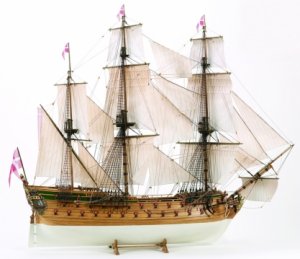

Photo by manufacturer
Manufacturer: Billing Boats, Scale 1/75
Type of ship: 3 masted warship, launched in 1765, deleted from the naval register in 1798
Measurements: Length 48.93 m, breadth 9.70 m, draught 5.07 m, displacement 1,076 tons, with a crew of 402
Price: around 325 Euros

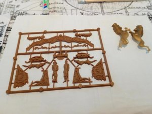

The kit has the number BB0437 and contains laser cut frames, different types of wood - obechi, mahogany, pine, balsa and plywood. Also included is sailcloth, copperthread and brasswire. The canons and the belaying pins are made of brass. The ornaments, the gallion and the hatches for the canons are plastic. Billing boats offers only a single layer of planking for the hull. According to Billing Boats, the Norske Love should have the so called Nelson look, the hull very dark brown colour with light yellow battery lines. The decks should have light tar colour, the gun-carriages should be painted red. The masts are included in different diameters, as well as the yards, which are partially sanded.

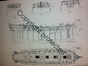

Included is a very good manual in different languages and several plans for sailcloth, rigging, position of frames and gun-ports in correct scale.
Another source for the ships original drawings are the Danish Naval Archives.

she is a beauty, but don´t get me wrong. There are some things, Billing Boats should have done better! Why only a single layer of planking, why are there no steps on the outside and why is there no dinghy? It was a coast guard ship! The hatches for the gunports are ironically the same as the hatches in the Wasa-kit from Billing Boats. You will find a lot of details to be improved, but such a kit should be payable and on the other hand there should be room for a modeler to show his skills.

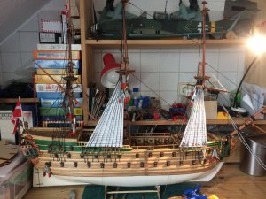

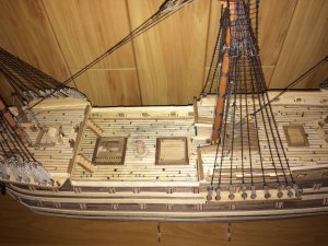

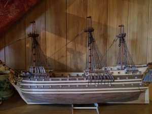

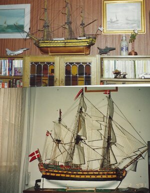

Sorry for first having seen you'd Build and comments. I have built 3 X this ship. The 1Th before Laser-cut, then 1982 1986.. I do not agree with your comment about the Manual. To my it is BAD. I knew Billing Boat and its owner Erling Billing -who passed away to early. I was at that time in a Neighbour Town, I did the 1Th and the rest without a 2ND layer. yje1Th with some problems, but no more. You are right, there are many differences from other big warships on one side. the other side Billing wanted and still do to make the kit as cheap as possible, so some part is used here which goes into another build. The last Gunport, to be glued outside the hull, Gun carriage etc I changed into Wooden, The last build I made I probably only used about 70&. The Gallery figures. I remade completely the Galleries
I am today living in Span (45Years now) but have tried to make- contact with the owners in Viborg, but NO interest to talk with a builder with 50 on its back. During my time in Denmark, I build about 10 models from Fisherboats, trawlers, Lila Dan Cosatboat Bent. all having the same defect. to the cheap and wrong material, lousy manuals, yo have a low price. When I came to Spain I changed mainly to OCCRE-100-150 € more expensive, but worse money. in this very moment, at least 3 builders are building the Montanes. Special Wirek Poland.. Here you on this side you have a German colleague building the Sistership to Norske Love: Prinz Frederich. the picture are taken just after arriving in Spain in 1978 with a lot of mistakes. at that time no computer etc. on top is the Victoria TOTALLY cut each part out by hand. Before Laser Cut
