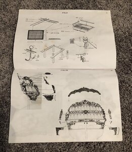

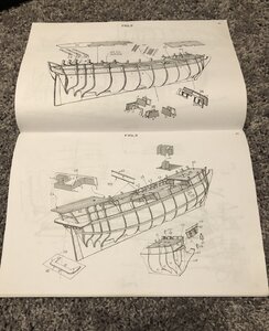

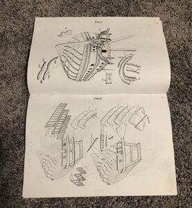

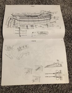

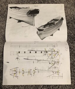

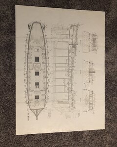

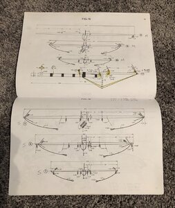

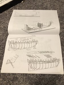

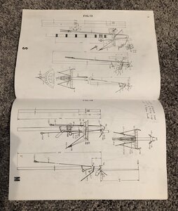

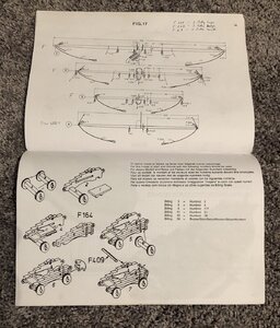

The assembly manual, although light on text (at front of book and refers to illustration numbers), has good iso views and was adequate information in my opinion. Between the iso views and full scale plans, I had no issues understanding what order to build and what to use.

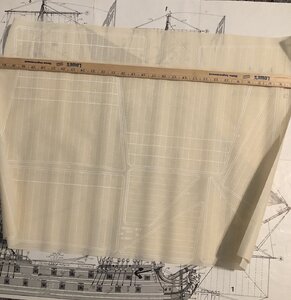

In addition, the rigging plans are on a full scale sheet and also in manual on the mast building pages. Belaying pins are numbered on the full scale plan view. So between those three sources and a lot of studying, the rigging can be figured out. It is all numbered so you can follow the lines from the mast build sheet to the full scale rigging plans to the belaying pin layout. Hope that all makes sense. Being a newbie, if I can figure out, anyone with experience will have no issue.
Here are views of the manual...71622E92-E475-48C6-B525-A325D3241B5B.jpeg3B49755D-5C34-4568-BF3A-DF441256F3D7.jpeg1E312C64-3342-4480-8447-30A920C6A0A6.jpegE51B8B85-3D90-4936-9095-FB0B1884A073.jpeg0188354A-6028-41D3-B8F2-2FD2819F1D87.jpeg

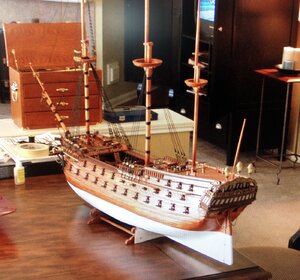

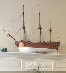

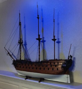

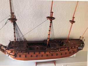

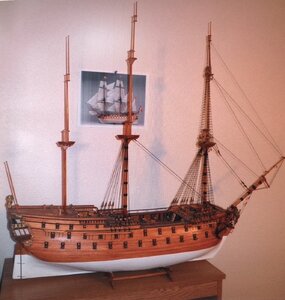

Unfortunately I don’t have build pics, but these are the pics I have of my last stage of progress. Ship finished, masts built and standing rigging started. Basically the shroud lines and forward stays.

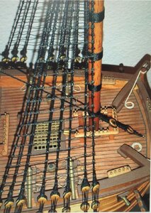

The kit came with a light brown for the shroud lines, I chose to order black waxed rope and use that instead. I served the lines at the dead eye and other areas with regular black thread. A dot of CA and wrap around line. Rat lines were done with individual clove hitch’s... too many to count. I would tie, then use a board to line them up in a straight line, then tack in place with glue and snip ends. The board I used to move the knots in a straight line was also used for spacing the next row. I would put the board on the previous row and push the knots on the new row down to the top of the board...working my way up to the crows nest. Just a method that worked for me. Not sure how others achieve level rows and spacing? Dead eye spacing was achieved with a bent paper clip 90 degrees on both ends at proper length. That was my method of madness...lol
Here are the pics... 0C9117B0-D3CE-42FD-A67E-D46BA2FD67F9.jpegCF8E6F45-79BC-4406-B0D9-32B265595E12.jpeg

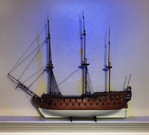

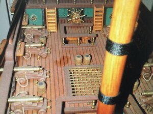

This is the remaining pics I have. Sorry for the quality, but it’s all I have. First pic was in need of dusting...ha ha. I bought some barrels and buckets to add next to cannons. I chose to leave railing posts gold to add bling and go with gold and brown color scheme. In retrospect I would paint them to match railing, and I would blacken the cannons. In addition I would plank the deck. But once again my first effort. I do want to build this one again, but better knowing what I know now!9BA83B20-E6B8-4725-905A-444C68F2374B.jpeg3C8C358C-C29C-4E91-88E6-3172B4B25D59.jpeg6AFDEB02-DB96-4018-9E32-C38F86002713.jpegE34AAF51-7B11-40CD-B917-BB720FFB648D.jpegD4B635A5-7CFC-444B-9222-C9AD089E6363.jpeg8C3D10EE-9B1D-45C9-A5BA-11B85CF9362C.jpeg
Another technique I used, for the water line, I put ship on stand and used a square on the keel to level the ship. Then I took another square with base on bottom and taped a pencil to it at the water line height. Then I slid it around the ship scribing a line that I used to tape before painting the white. Not sure if there is a better way?

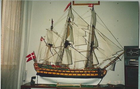

I bought this kit in 1989 and I was going to say that the instructions seem to be the same. I had never made a model before, but when I came across this model, I couldn't help but buy it, despite the seller's warnings. He was right. I had a lot of trouble finishing it, but I did well overall.
Today, it's still not finished. Worse, it is now in parts, mainly due to the multiple moves I had to make between Europe and North America. She faithfully followed me but I abandoned her to her sad fate.
I discovered SoS and I'm ready to get her back on her feet.
The only thing I didn't like about this Billing Boats model were the colors used. The green in particular, which distorts the final appearance of the ship, I think. After many readings on SoS and other sites, I'm not sure that BB followed the colors of the time. If anyone knows what colors the Danish navy in the 18th century used, it would be appreciated.

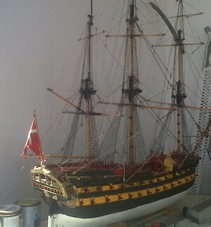

Over my more than 40 tears as a builder, I have over time build 3xNORSKE LØVE, and on the Billing, boat side .giving help to 3 others (South Africa, New Zeeland and Canada- so I now very Well the good and much more the bad side. The first one was from before Laser-cut, so it was all hand cut. Have .just seen your side this moment .t The pic. is the hand-cut from early 1970 with some mistakes with the sails. It lasted 40 years- the last 5 on the seafront of the Medetiranien seas in Malaga Spain. This destroyed it-mainly the riggen -high humidity., high temp, dessert sand storm from Sahara I took it back to try to restore, but not only the rigge01 Norske love 1.jpgn, but the hull too, so last voyage -after surveying the trip from Denmark to Spain-the waste bin. the second image trying to restore. the first one was taking in Madrid
