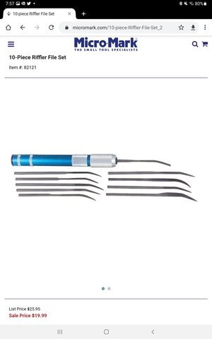

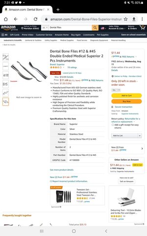

You could try dental bone files and Micro-Mark sells micro rifflers too.

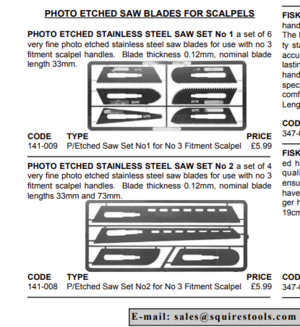

Not sure what you are trying to do, would these help?
Fit Swann-Morton handles, I get mine from Squires Tools UK, very good.
The ones that are giving me the most trouble are the ledging notches in the lodging knees. I've tried notching the knees before I glue them in but they are rarely in the right spot so i have to adjust them. It's better to try and do them in place but that has it's problems.
