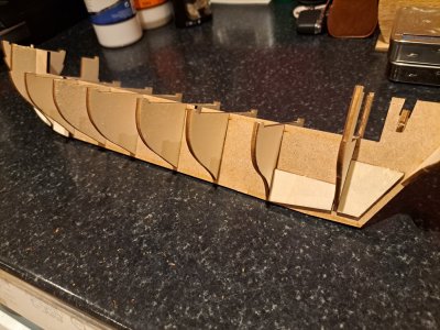

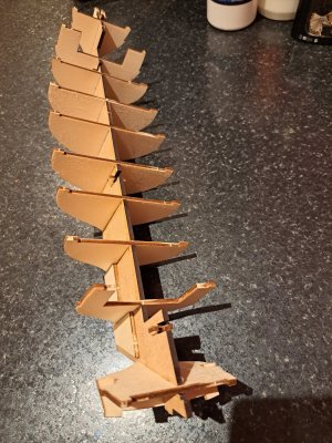

I haven't posted much about my build yet so this is a catch up of progress so far.

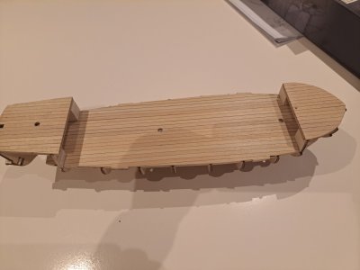

Firstly the easy bit of constructing the frame, well what should have been easy. I found that the pre-cut frame pieces were not marked so I had to use the deck section to get them all in the right position before gluing. It was only a short while after I found a schematic in the plans showing where all the pieces were. First muppet moment :rolleyes:

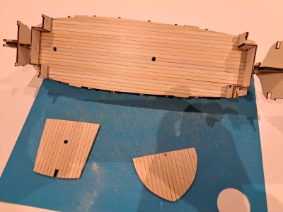

Then work started on planking the deck.
I cheated on this part by cutting the deck planking to shape using my bandsaw.

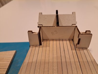

Then the fore and aft bulwarks and decks added.

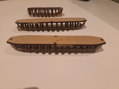

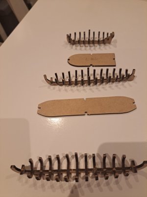

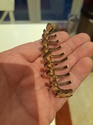

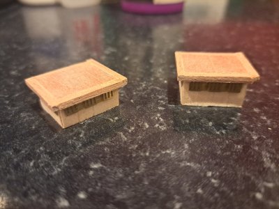

Then I was waiting for glue to dry so I made a start on the small lifeboats?
I am not looking forward to planking these as they're so small :eek: Then onto the planking of the hull.

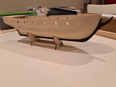

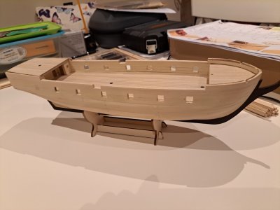

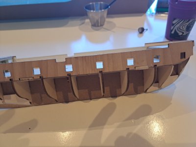

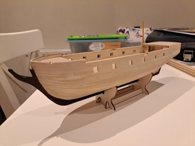

I didn't remember to take photos during the planking but here is the finished hull after first planking. I'm thinking the secondary planking will be easier as the 1/2mm thick boards will bend so much easier than the 2mm boards of the first planking. Also you'll notice that I've planked over the fore and aft gun ports as they were defunct, and I thought planking over would look better than fitting dummy doors to the ports.

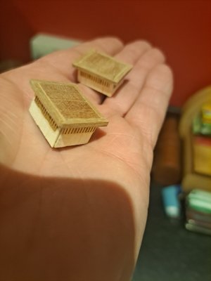

And I've also made a couple of the deck parts (not sure what they're called).
And that's the build so far folks (constructive criticism always welcome). I might make a start on the secondary planking this afternoon :).
Looking very good so far. You copied me by framing out the dinghies early. You are correct, they are very hard to plank. I have done one of them so far.
Keep up the good work.
