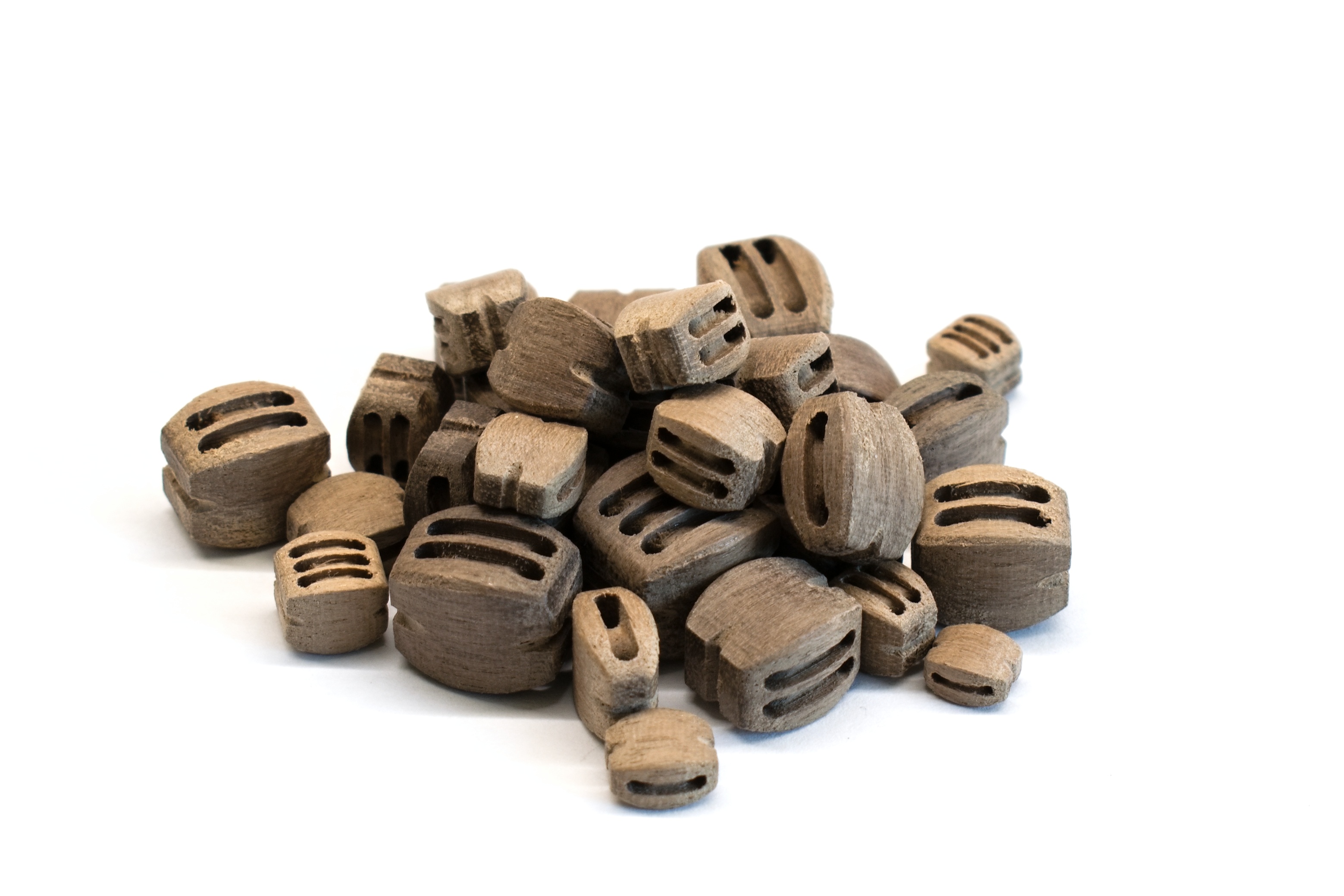

I ordered a bunch of blocks from Dry Dock. They arrived yesterday. Beautiful blocks. I don't know how these things are made but they are nice. Stropping the 2.5mm blocks is going to have a very steep learning curve. It's like trying to tie a line around a poppy seed:) I've found lots of videos but most of them don't seem to deal with the very tiny blocks. Old, shaky hands don't help:)
Anyway, very nice blocks.

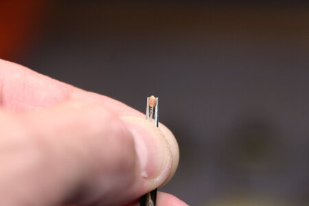

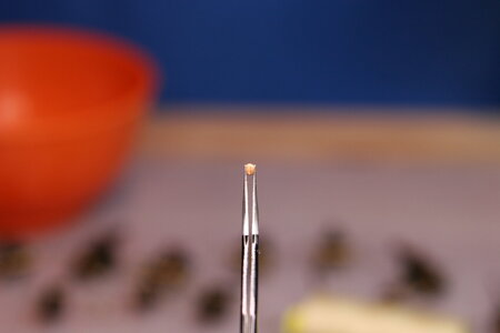

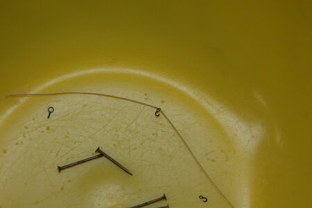

Hi Don (@Don Case),
I'm no expert but this is how I solved the puzzle of stropping these tiny blocks.
I grabbed the block with a tweezers and then pushed the handles of the tweezers into a small vice mounted on my worktable in a way that squeezed the tips of the tweezers firmly around the block. This left both hands free and the slot for the stropping available and visible:

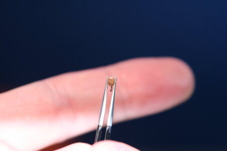

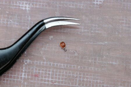

I was adding hooks, but the same next step works with a becket. I tied the stropping line to the hook and then wrapped that around the block holding the ends of the line tight:
After using CA to secure the lines I cut off the ends. Not a proper stropping but good luck seeing the difference on these little blocks:
Hope this helps!
