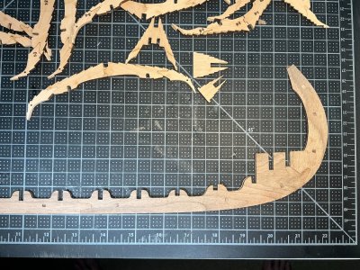

Hello friends... I also want to build an Oseberg... at the moment, all the model kits have a straight keel... I think it has a keel... I want to build it according to the updated drawings...View attachment 576198
this is how Pavel formed his kit. I don't see any issues whatsoever - in fact seems to be right on the mark IMO

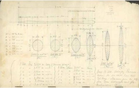

Hi Patrick,
Welcome to my build log!
The actual oars on Oseberg measured between 370 cm to 401.5 cm overall (the different oars that were found varied in length.) That puts the 1:25 scale oars at 14.8 cm to 16.06 cm in length overall. The blade maximum width was around 175 mm, making the scale blade around 7 mm.
I have not seen the new laser cut one-piece oars except in pictures. My kit was an early one with dowel shafts and separate walnut blades. I have planned from the beginning to fabricate my own blades because those that were provided look nothing like the original.
