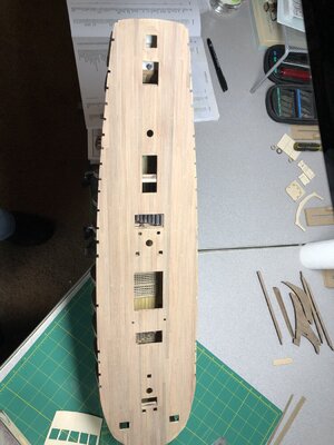

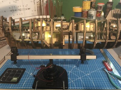

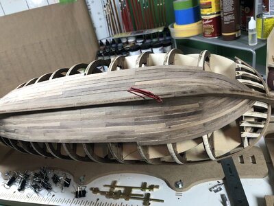

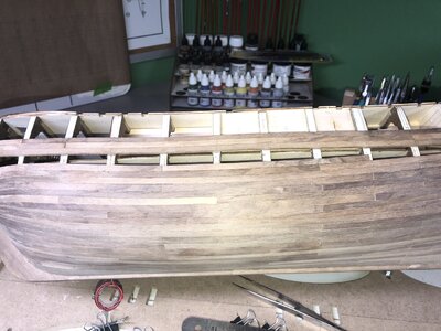

We must have similar versions... except my version has the open side.
Pictures would help... Hopefully, you can get the camera working soon!
I've attached a couple from my current build.IMG_4537.JPEGIMG_4749.JPEGIMG_4984.JPEGIMG_5330.JPEG
