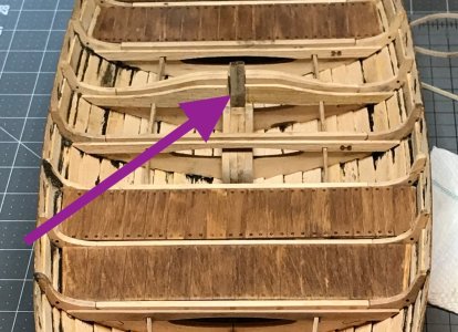

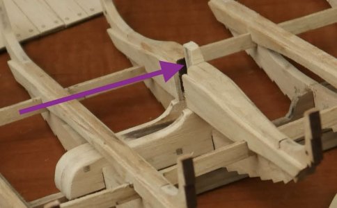

Question: When you glued the double biti's together on now frame one, did you sand it down to the same profile as the original version of the kit...using the supplied stencil that Pavel included? He doesn't show if the profile is the same in the plans with his upgrade kit.
Hi Steve,
That process is a little different with the upgrade. The second biti is in two pieces and sits on the mast step leaving enough room for the mast base.
My build.
Pavel's build
Jan
