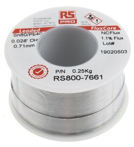

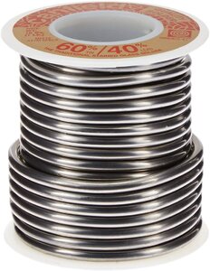

As far as I am aware the only difference between 50/50 and 60/40 is the lead and tin ratio and therefore the melting temperature is different also the strength.
Yes a wire without rosin core is preferred, over here in Australia I found buying plain lead solder very expensive compared to buying normal cored or electronics solder.
When I got the solder bar from the hardware shop it wasn't really cheap but then I thought it would be a life times supply for me, the same apply's to the flux I got it is the smallest tub they had but still more than enough for a lifetime and not really cheap though not all that expensive either.

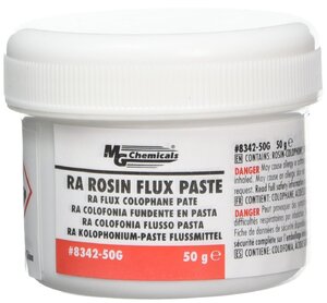

I did not fond all the materials proposed, so , finally, I purchased these soldering Materials :
  • Hakko FS-100 Tip Cleaner ;
  • Canfield solid wire 60/40 (no core). I will cut chip or or make flake with cutter ;
  • MG Chemicals Rosin Paste Flux .
Thanks for everyone who have contributed in this thread.
Canfield Solid wire 60-40.jpgFS-100 Hakko.jpgMG Chemicals Paste.jpgMichel
