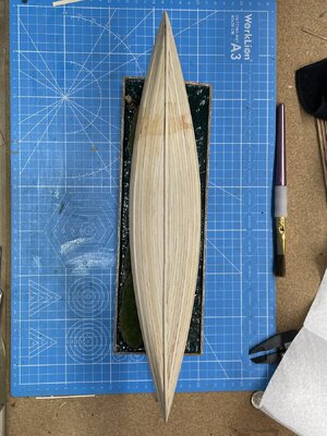

I saw your problem with the planks rising off the forms . I fixed this building the whitehall boat. It is nerve wracking. I put tourniquets around the hull. Tightened them somewhat. Spray with windex tighten more. Repeat over and over. It’s amazing the stress it took

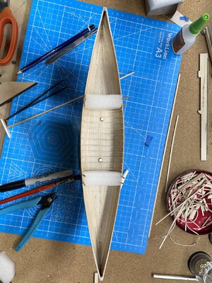

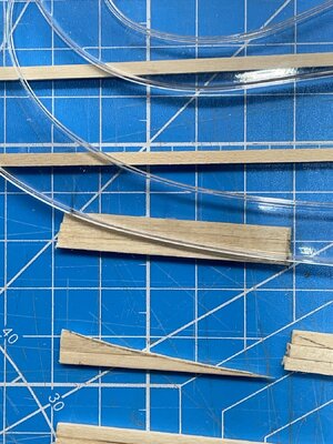

The ends of the canoe curve up. 3 small wedges are to be glue on and beveled to the stems. I decided to just glue 3 planks together. I found the curve by just moving the french curve around on the plan til I found it. Then I marked the french curve at both ends. Traced the line and cut it with my knife.
I haven’t glued this on but I did check that they fit. I sanded both inside and out of the hull. To keep the ribs spaced and as straight as possible I transferred from the plan a template on a leftover plank and marked the bottom on the hull. I made a spacer and covered it with packing tape. I usually make these kind of thing during the thinking time and not to doing time:) Most of time they are of little use and pile up on my work area.

This is where I’m at on the canoe.
After I’m finished with the rib supports, I’m thinking I will need to finish the inside of the hull. The floor boards and thwarts are cherry and both decks will make it hard to get under them.

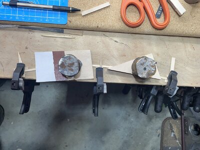

I’ve done a few test on scrap wood with products I had on hand. I would like the finish to be reddish, kinda like cedar. The first I tried, knowing it wasn’t going to work was a rusty walnut gun stock stain. Because I used CA I’m probably going to use something that covers and transparent, like shellac. Here’s the sample with stain.
If the CA isn’t sanded off, the stain wouldn’t take. I have amber shellac, but I’m not liking the yellow tone.

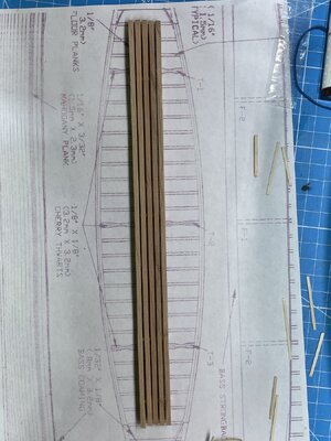

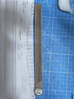

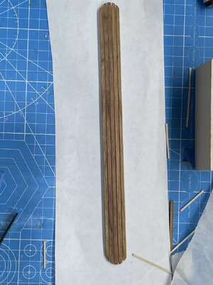

Next was the floorboards. I copied the scale plan and glued a few scraps of planking in hopefully calculated spots:)
Then I glue the planks down one by one, lining them up with the plan.
I used a 1/16” piece to space between them as I glued them to the wood brackets.
I found a nickel was just about the right size diameter for the ends.
After it had dried I cut the paper off and finished it with Tru-Oil gun stock finish.

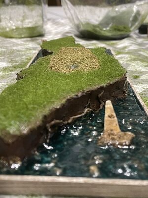

On the base I added some 7mm and a little 12mm grass that will be on the outside of the canoe when it set on it.
I can’t decide what the bush is going to look like. I’ve made 4 different ones. None of them have made the selection yet.

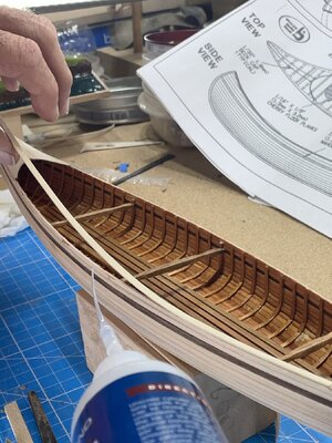

I edge bent the gunwale plank. It seems I’ve used this way to bend the majority of the planks on this build. Not very impressive to look at.:-)
Although the false keel I used this iron with a large aluminum head, which if it’s not on long it won’t get hot enough to burn the wood.
I used CA to attach the gunwale, just glueing a little bit at a time.
After one side was down I soaked the left over plank in water for about 10 mins. Then run the iron over it on both sides just to warm it up.
After that I easily rolled it around a paint top that was similar to the diameter.
Letting it rest on the gunwale I pushed it in place and clamped it to dry:-)

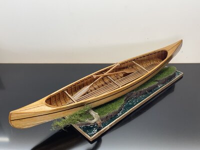

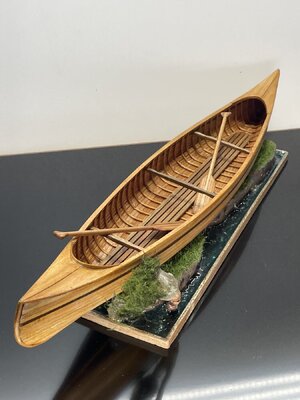

Finishing time is almost here.
Congratulations for finishing this fine model - very well done
