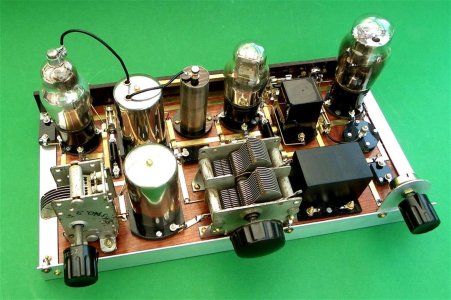

Looks like a three tube superheterodyne receiver. No power supplies, usually batteries. LT was probably 6V and HT was probably 67V.
There wasn't a power supply as such, it was a battery set. Two Volts LT and 90 to 150 Volts HT.
It is a TRF (Tuned Radio Frequency) RF amplifier, detector and power amplifier valves. The metal screening cans are old salt cellars, and the RF, detector and RF coils are inside them. The coils ar e RF chokes, very small -
Vacuum tubes typicallyrequire a Plate Supply and of course the cathodes require a filament supply. Some plate voltages can be as high as 680V and filament was usually 6.3V but I am recalling this from my old, old brain.....we used to call the plate supply "B+".....
You guys didn't see the battery B1 below and to the right of V2.
Yes, but it looks like it's just there to bias the grid in the audio amplifier tube. Follow the schematic and you'll see that it never makes a complete circuit - it's always blocked by capacitors (which don't pass DC). The power comes in from the far right - one voltage for the tube filaments (LT - 2 volts) and one for power (HT - 90 - 150 volts).

Thanks for replies on the blueprint. This vintage replica that I designed and built represents an era far earlier than 6.3 Volt heaters.
It is a battery set, and the valves are directly heated, dating back to the late 1920s or early 30s.
The filament voltage was two Volts obtained from a 2 Volt rechargeable lead acid battery.
The HT for these valves was officially 120 Volts from a block battery composed of 80, 1.5 Volt dry cells connected in series. The small battery on the left of the output valve is a modern CR2032 button cell, supply negative grid bias to the output valve. No current drain at all.

I am pleased to see so much interest has been shown, usually, I just get bank stares with eyes glazing over if I show it anyone. It works very well.

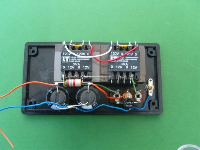

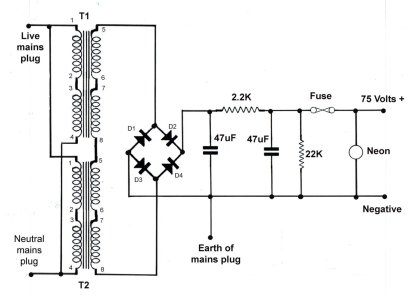

If you want a power supply, here it is - 75 Volts is enough for this radio receiver. I know that four times 12 Volts comes out at 48 Volts. But 75 is available at the output. The LT for the filaments is from a modern 2 Volt sealed lead acid, rechargeable. I altered the value of the
2.2K resistor, and added the 22K bleed resistor later -
View attachment 519998View attachment 519999
That makes perfect sense. Most 12V (nominal) transformers are actually 12.6V RMS (root-mean-square) which is (in layman's terms) kind of an average of the voltage of a sinewave. Peak voltage, however, is the maximum voltage that the sine wave reaches and is what is passed through the bridge rectifier. The four 12.6V transformers in series would put out 50.4V RMS, which comes out to 71.33V Peak.
