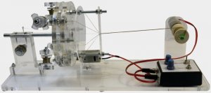

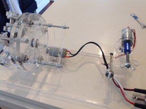

Yippee, been waiting for this baby to arrive in my mailbox, and I am so excited !
Its the Alexey Domanoff ropewalk machine which I believe is probably the best value for money machine on the market, considering it can lay from 2 - 4 strands of thread in left or right hand ropes.

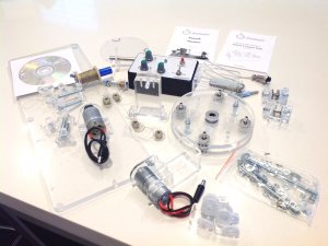

Just finished assembling this and it was quite easy. It came with an instructional disc which I could watch as I assembled the machine and there are also videos on u tube.
Now I need to go and buy some thread and do a few practice runs.

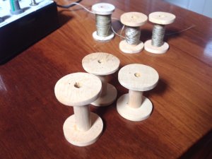

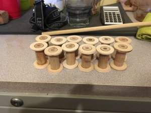

yes this machine is a wonderful ropewalk and probably the best on on the market. I bought some extra plastic spools for the threads, but I could not find any old fashioned wooden spools, so I made some up myself yesterday.

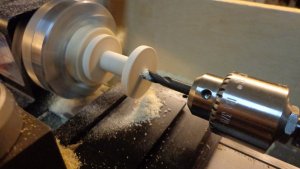

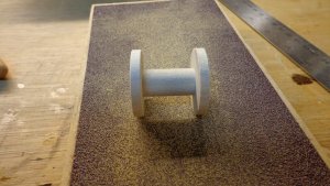

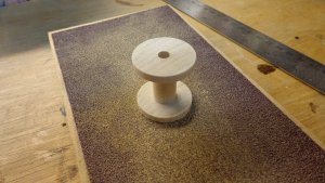

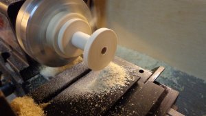

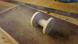

I hope that you do not mind me posting my work here. This first spool was a test of the durability of the wood / pressures of the lathe, etc. If I remember, the wood is Oak.
I think I have about 2 1/2 hours in one of these. That is just due to it being the first run and figuring out how to do it. I might be able to reduce the time down to maybe 1 hour each. The ends of the Spool are at 4mm instead of the 2mm requested. NO glue - all one piece machined wood.
I can also drill a small pilot hole on the shaft so that the line can go through to help hold. The hole will be at one end.

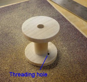

Brian,
do you need a threading hole? See the image (black dot). This can be a hole to keep and start your line from coming out. If so, do you have a preference? I think that .8 mm should be fine.
Yep, the spool was made out of a solid rod of 35mm diameter dowel and 1.2192 m long. Of course, I sawed off a piece about 50mm long to allow to insert end into lathe, therefore enough stock is left for working and parting of the piece.
