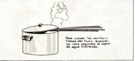

Interesting. Going to give it a go.This is how I bend wood.

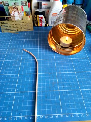

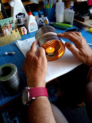

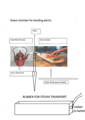

I made some adjustments to your original pic. Because of the quality of the original I couldn't do much, but I think it's an improvement?It is cheap and it works. I got the idea from a German Frind Axel Kullich -he has made the Pic. When I was building I nailed into a piece of wood, for holding it, and then a list of each side. but to, not to destroy your table. We need over 200ºC to destroy some of the bonds in this Macro molecule. Mechanical force can do it too, but not good for us
happy building and stay safe

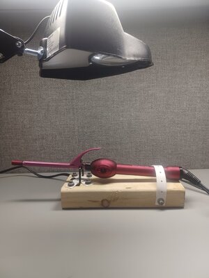

Hey... THAT WORKS!This is my makeshift plank bender. Don't laugh too hard. lolView attachment 398890
Compliments go to my wife for accidently ordering one too small for her needs. Been sitting in a box for months unused.Yup a tool is a tool, no matter it's original purpose
