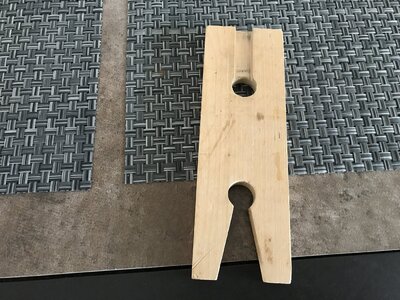

Here’s what I use to bend, the Sapelly is very hard to bend, it worked great. I made another block for the clamp on thing to go hands free
I like what you have done with the holder for that bender. The biggest drawback is the burn risk, or chance of that thing sliding off of a holder because of the weight of the cord and burning someone or something. When I use mine I wear an insulated "Lodge" leather glove used for handling hot cast iron cookware off the fire. It is clumsy but the large area of very hot metal is a danger. But it bends wood like mad!

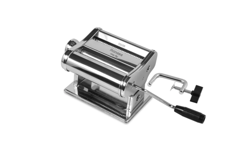

I own and have used this tool myself. I soak the strips first then crank the strip through the machine very slowly each time tightening down the 4 screws/rollers to increase the bend. It really helps to have straight-grained wood by the way. I use it when I am in a hurry and do not want to fire up the steam generator.

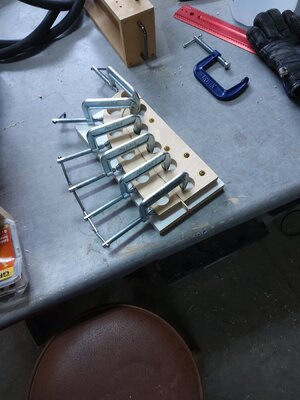

Steamed wood is a great way of bending. Steam for 45 minutes to an hour then clamp in a form until it sets and dries. A bending iron works well too if the wood is thin enough and has been soaked. The roller macine also works quite well but needs to be done slowly. I've tried and used all these methods. I have not used a tin can heated with candles.NetFinished1.jpg

Hi Stuglo, the tool you pictured looks very much like my pasta roller which can be adjusted to what ever thickness and pressure I may require.
