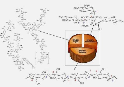

finally I found some pic. of the struktures- do not go to much into chemical problems. only that the 3 huge bio. products make a 3-dimensional structure. I general said to the student that is like building a house. The Glucose is the single brick, which together with the help of concrete-hemicellulose are glued together. The lignins are Stell or very Strong pillars which avoid that with the 1Th storm everything crashed

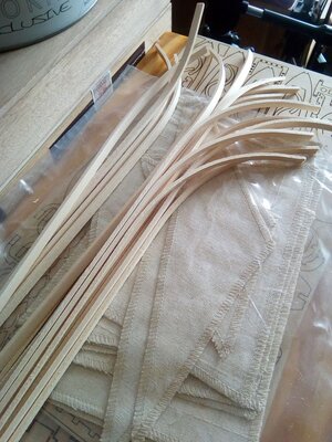

Out of all these methods, only a few is really working. some can be even harmful as caustic soda (NaOH). Soaking in water for a long time is either NO GOOG. The wood will such up water and by then1000 or more Bacterias, which can destroy de wood, so it is easy to bend and set nails, etc in, BUT the wood will dry out again, which gives some physical strengths, which can change the bulkhead position. In the end -after even having seen hear special equipment for bending- the is to me ONLY STEAM -high temperature- Electrically bending as seen here, with high temperature and FINALLY BUT NOT THE LAST "DRY BENDING" Many of you may not know it, BUT it WORKS and it is a very cheap tool. will add some pic. but it consists of an empty TIN (from Beans etc) which is Strongly faster too a piece of Wood horizontal. Now you take 3-4 candlelight (those from Chenice Restaurant, lit it and 30 min. later the tin is BURNING hot. Now simply add your planks -2mm no problem- and the good thing are, that the planks will stay bend, so one can make a batch
Why some are better than others, you will need to know, what is the raw material of Wood. You may be surprised WOOD is build up of 3 huge SUGAR molecules -YES sugar =GLUCOSE the smallest stone. The 3 parts is Cellulose 40-60% -HehiCellulose 40-60% and about 5 10% Lignin. Each sort has a different amount of mainly of Cellulose and Hemi-celluslose. To destroy this HUGE tridimensional Biochemical complex WE NEED a very high temperature

I used Steam with very results. This Hot electricity device was not me. The HOT DRY METHODE es to me absolutely the best I have tried -have more than 40 on my back in building. The good thing with the dry method is that they STAY CURVED after treatment. On the pic. you see a batch done without further treatment. Everybody should use what they find the BEST one. I was just trying to tell you something, new-All builders) From the same person, I have got info about HOW TO SQURE GUNPORT by drilling.

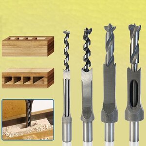

Tried all the above - they work fairly well with thinner wood . Just ordered this and will see if improved without distortion with thicket wood

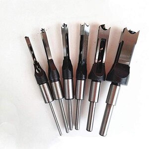

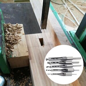

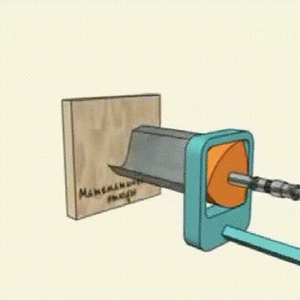

You would have a hard time using those square hole bits on a hull, pretty much useless for gun ports.
My German Fring Axel -with the dry Bending -made all the gunports on Victory in less than 2 hours, but if you have closed the hull with decks before -problems.you can't the gun port frame inside now.

In regards to these square bit drills: these are used in a mortising machine. Very useful in making perfect joints when making furniture. I don’t think one would meet with success trying to cut gun port openings. The video you supplied shows a mortising machine in action. The hull of a ship model won’t fit under the machines holders. If you have success cutting square holes in a model with these bits I applaud you. Good luck.

Mi friend from Germane Axel Kaullich -the one with the dry bending- confirms that it function. I cannot confirm it myselves, as with my nearly 89 years old, Ido not build anymore. so if you believe or not is op to you.sorry
And in addition you would destroy your work that you did with the hull. I find the only thing that works for the portholes is to drill small holes around the perimeter of the square, or parallelogram, and then using the old Xacto
