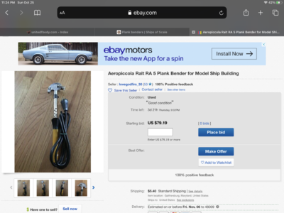

I've found that dry heat works best for any kind of bending of wood and have always used an electric plank bender. My first one from Aeropiccola lasted 30 years and finally died last year. I bought another last year and it's doing fine.
