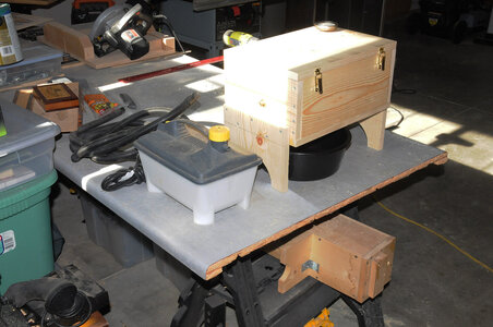

Phil,I steam the woods when possible then clamp in a jig or form while they dry.
circular item is a oven thermometer. the steam source is in the picture to the left of the box. i bought it at Woodcraft. it comes with the hose and fittings. its the Earlex steam generator. uses distilled water.Phil,
can you give me some specifics on your setup. What’s the steam source and what is the circular object on the top of the of the steam box.
Phil,

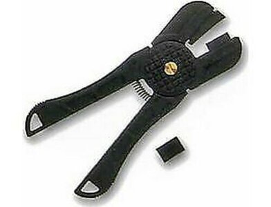

This may be cheating but I have used this tool to put grooves on the backside of the plank to get the bend I want. Practice with some scrape as to how many grooves and at what depth. Got the tool at Model ExpoWhat’s the general consensus regarding different fluids for softening wood prior to heating and bending. Water, alcohol or ammonia. If alcohol, what percentage. I normally use 95% for other things.

The Blank bender from Artesania Latina is working with the same principle - good idea and working well - especially for the first planking on a POB double planked modelThis may be cheating but I have used this tool to put grooves on the backside of the plank to get the bend I want. Practice with some scrape as to how many grooves and at what depth. Got the tool at Model Expo

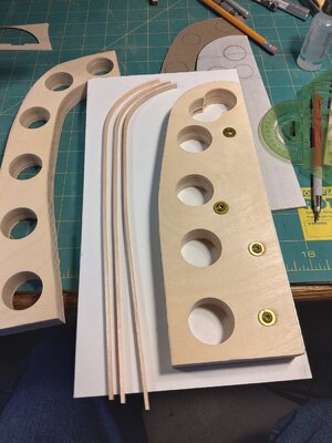

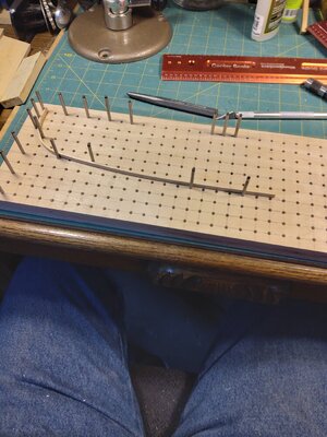

The technique is from Chuck Pasarro's yt video 'planking the Winchelsea'.I just wet the plank and bend it on a plank blending tool. I can’t remember where I saw the idea, but the difficult bends I make a form the same thickness of the plank, soak the plank, then bend it around the form, clamp it down and use a tiny steam iron to iron it. Works great. Thank you to whomever wrote that article on using a steam iron.
