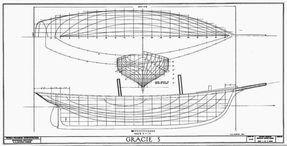

Then you have plans such as this one, there is nothing to tell you what the stern looked like, what the figurehead was, nothing on the deck layout, no construction detail as to framing or timber sizes the plan is just the shape of the hull. To build a model from such plans you need to use other sources such as the "establishments" which is a document giving general timber sizes but not things like deck layout.

the Dictionary of American Naval Fighting Ships which describes Gracie S. as "length 83' 0"

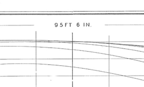

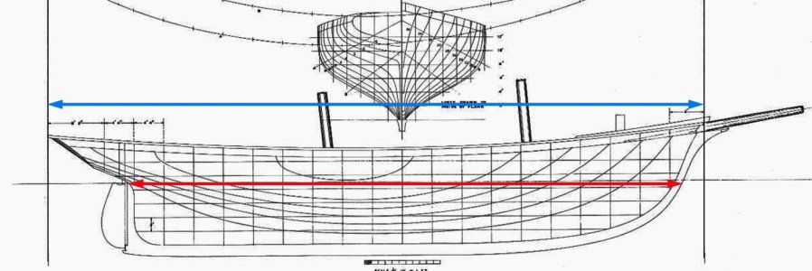

when you look at the hull line drawing it says 95 feet 6 inches. Who is wrong? actually both dimensions are correct because it depends on who is taking the measurements and how ships are recorded and what exactly is being measured.
so what is going on here?
Length overall (loa): and Length on the waterline (lwl):
The 95ft 6 in is the LOA measurement and the red line is the LWL
Dictionary of American Naval Fighting Ships list the length of Naval ships at the LWL Admiralty drawings may record the length on deck or between perpendiculars. Then even between perpendiculars breaks down into overall and from the back of the stem to the front of the stern post. Then we have the add measurements which calculates the cargo capacity and cargo weight a ship can carry.

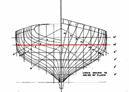

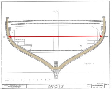

Width or beam or extreme breadth:
this is shown on the bodyplan
in the case of the GRACIE the draftsman noted lines drawn to the inside of the planking.
Some plans do not indicate what the breadth measurement is. But for model building it may not matter because at 1:48 scale the planking is about 1/32 thick so overall it is a matter of + or - 1/16 smaller scale the difference is minimal.
